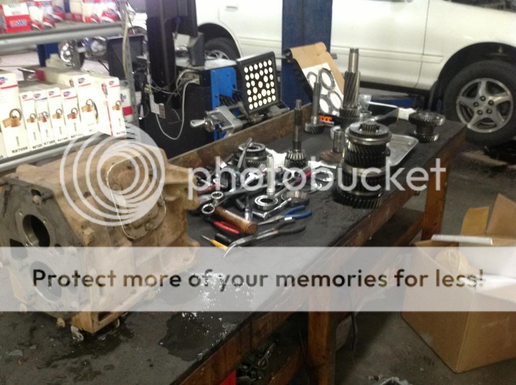

Postby Stoner93 » Thu Mar 28, 2013 1:37 pm
I've got a 93 w250 extended cab with the piece of crap auto. had a buddy rebuild it for me and less then 500 miles it lost 3rd 4th and reverse so I'm going with the nv4500 swap. I just put a rebuilt one in my father in laws 91 and kept the core to rebuild. I just ordered the parts for the rebuild, had to get a new input shaft and cluster shaft. Still need bell housing and master/slave, shift tower, 23 to 29 spline coupler, clutch pressure plate flywheel,and to fab a cross member tranny support. I have a peddel assembly. Tranny is out of a 98 and newer dodge so it has the square shift tower with the updated main shaft/fifth gear nut. All together the swap will cost right around $2100. Can't buy a "good" rebuild auto for that not one that will hold up...
The truck has a small lift with 35" tires. I put pods in it cause I was at runaway with my stock auto injectors and the pods were free... turned pump back down to compensate for auto rebuild but that obviously didn't matter. Will turn it back up for the NV4500 wanting to put better injectors and a 3" intercooler already have the three inch intake to install. Stock from 01 cummins hope it works... Also free...
If you guys have any advice about any of this let me know. I have thought about going the other way with it and converting it to a duelly for all the towing I do but we'll see need some money for all that plus that's six tires. Feel free to blow up my board and tell me what I am doing wrong. I appreciate any feedback.

Tearing into the tranny today ordered all but 23 to29 spline coupler and shift tower / boot.

Postby Stoner93 » Thu Mar 28, 2013 4:39 pm
Got it torn down today will continue the build tomorrow
