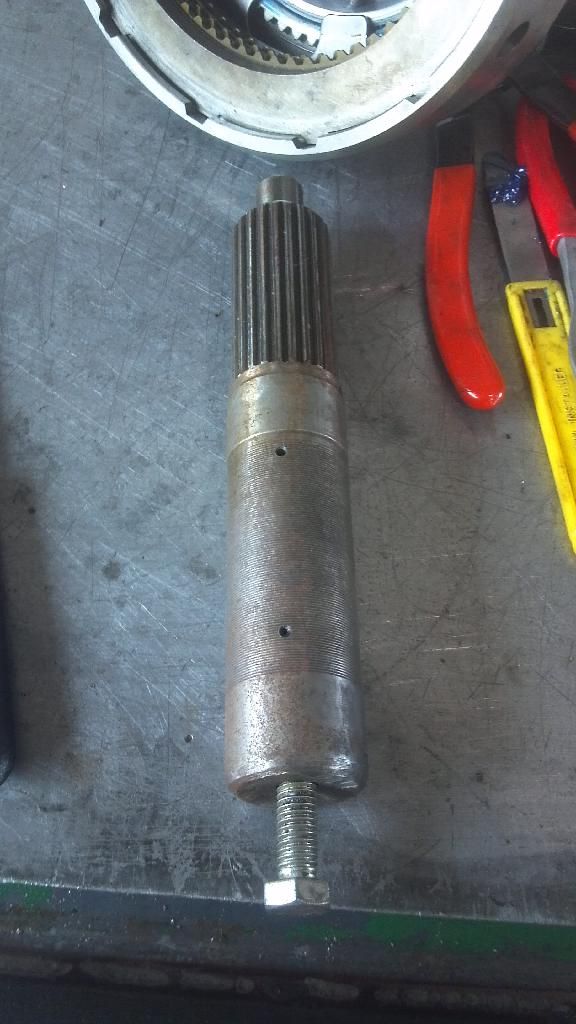

ellis93 wrote:Image
Ellis, it worked! It doesn't leave much room to get the round snap ring in, but it's not going to bend or cost $100+ either. 8)

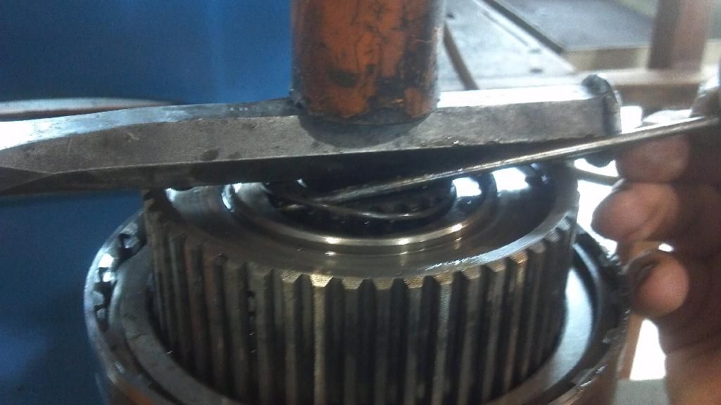

ellis93 wrote:Image
ellis93 wrote:Image
I cut mine about 1/2" shorter after cracking the bottom/rearmost thrust bearing trying to seat the round snap ring. Works good.
Just a tip for all you rookie transmission builders out there: if you need a handle for the jack in your press, something is bound up.
