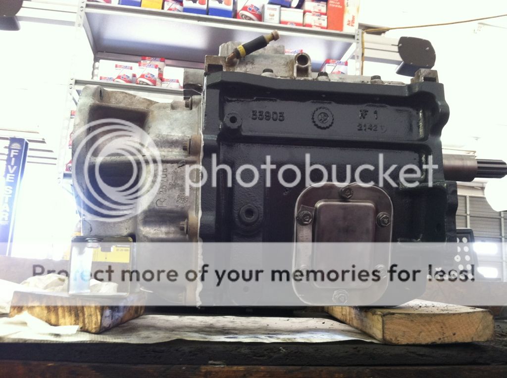

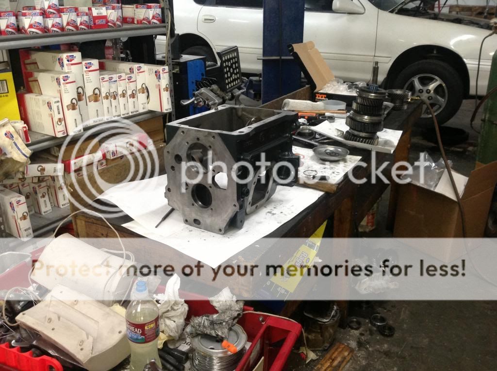

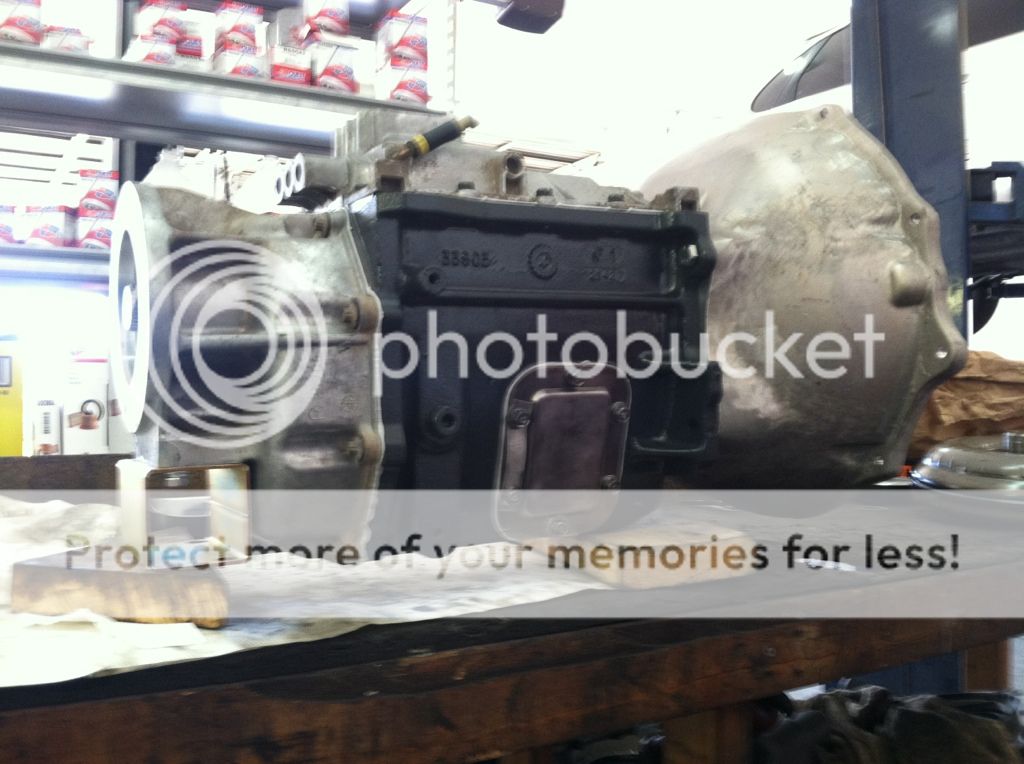

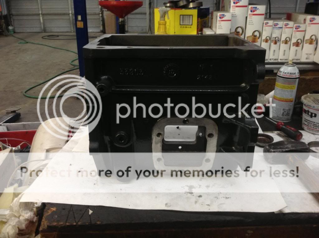

Hey thanks it was only the first synchros right by the input shaft that gave me a fit. I got it all apart and new synchros put on. Git the case sprayed and will install cluster, main, 5th and input shaft tomorrow... Some pics of the progress

Postby CumminsPower59 » Tue Apr 02, 2013 9:35 pm
You're really moving along, looking good!

stoner--not here to rattle your cage, but i'm going to bring this up just because you haven't mentioned it--you need the second gen engine adapter plate and starter to run the nv4500. i learned this the hard way when i started out (and never finished) mine. your picture inspired me to paint my trans, as i hope to tear into it soon (once again). hang in there.
