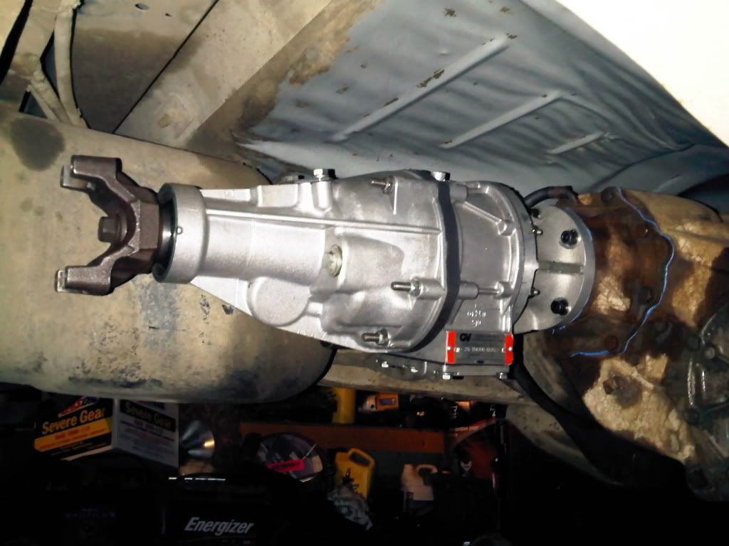

Where does the GV mount? AFter the trans? Will it work to give an auto even higher gears on the hwy?

If its 2wd it mounts to the back of the trans, 4wd on the back of the t-case. There is a divorced mounting option aswell. Yes it gives a greater OD to autos aswell.

Postby PToombs » Mon Apr 23, 2012 4:27 pm
That looks like a lotta extra weight hanging off the back! :shock:
Re: Junkyard Volvos=Gear Vender?
Postby BILTIT » Mon Apr 23, 2012 4:33 pm
Its actually not very heavy. ~40lbs
If you think about it, the whole t-case (200lbs?) is hanging off the back of the trans itself.
Derek B.
BILTIT
Posts: 711
Postby PToombs » Tue Apr 24, 2012 5:35 pm
That's true about the TC, but it's fairly close to the mount. The GV sticks way out. 40 lbs isn't much though.
