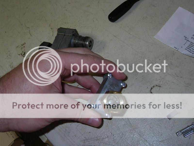

Well the other day I received my ratio adapter for my speedo. I figured out that I needed a +20% VSS signal to get my speedo to read right.
I went with PATC. Very happy with their service and product.
Speedometer Gear, Speedometer Gears, Ford, GM, Dodge 700R4
Here's some pics...
Original and new unit....
And the ratio on the OEM unit. The 1.04 equals a +4% VSS signal.
And the new ratio at 1.20. So +20% VSS signal.

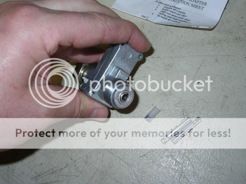

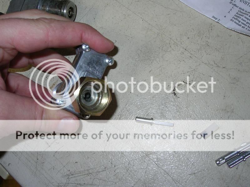

The ratio adapter from PATC must be a generic piece to service more then one application. SO it came with a small adapter kit as well.
I needed the square head for the transfer case side...
And the VSS side I needed the plastic insert so it would except the VSS square drive shaft. You can see it in the back ground.
And installed and ready to go.
