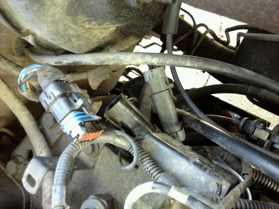

Postby tatkins85 » Sun Oct 30, 2011 10:22 am
got it working after unplugging this harness. anyone know what this harness is? tans? fuel pump?

Postby Tacoclaw » Sun Oct 30, 2011 10:25 am
tatkins85 wrote:got it working after unplugging this harness. anyone know what this harness is? tans? fuel pump?
Tacoclaw wrote:Quick way to check the trans is to just unplug it's connector up near the firewall. I rethought this, and it may not work due to the park safety switch. If it blows from just going to key-on, it should work. If you need to crank/start it to test it won't. :(
That's your guy. ;)
You've got a short to ground on your trans wiring. That sends hot to your 4x4 sensor, park safety sensor, speedo, and whatever else is down there. Check every inch of that big blue wire as it goes down there, then start checking any wires that splice off of it\.

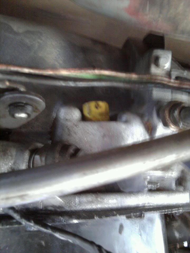

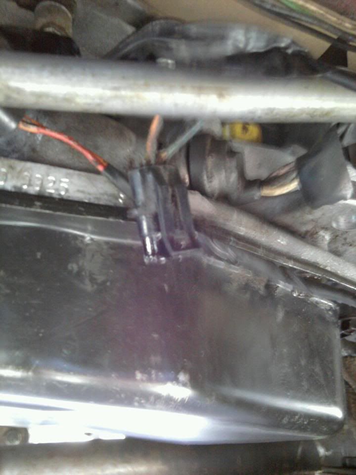

Postby tatkins85 » Sun Oct 30, 2011 11:56 am
ok so i tracked it down to this connection on the trans. pulled back the tape and it looked like the wired were pulled out a bit and were touching each other. pulled it out and pulled the wires apart and everything is good. but when i put it back into the top of the trans it blows the fuse again. could the sensor be bad or does that sensor send out a connection to another part of the trans, so my search needs to continue?

Postby dazedandconfused » Sun Oct 30, 2011 12:15 pm
I believe that is the neutral safety switch. I'd folloe the rest of the wiring to be safe but I suppose the swich could be shorted. Which trans do you have 518 or 727? 4x4 or 4x2?
