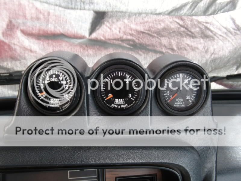

Well the tach hasnt worked the last two times that I have driven it. So,, now that you ask the question, I went out and checked to see if it was charging, and no its not. I guess one of the reasons I didnt know was it has
2 brand new batteries in it. But they are showing below 12 volts. So is that the alternator? or something in the
ecm? And would low voltage keep my fuel shutoff solenoid from working properly? thats an added question. Heres a pic of my guage setup. The 2 on the left are RW products, ? Manifold pressure is isspro.
