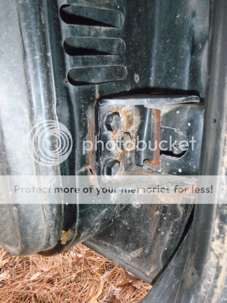

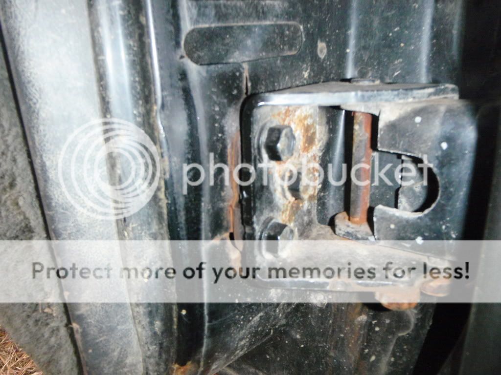

Postby Diesel Dan » Sun Dec 28, 2008 10:17 pm
Here are some pics i promised and was wonderinf if you could explain the easiest way to fix this..
with a thin plate over the crack the size of the hinge footprint
or
just weld the crack

Postby dpuckett » Sun Dec 28, 2008 10:32 pm
Looks like a typical Dodge door to me. I'd have to think about how I'd fix it, short of replacing the doors. Involves a MIG and sheetmetal.

Postby PToombs » Mon Dec 29, 2008 5:35 pm
Yup, mine was cracked like that. I had over 1/2 a day in fixing it, but I went overkill. I removed the plate inside that the bolts thread into, and built a reinforcing plate to go under the threaded one. I cut and fit it inside, welded the crack inside and out, ground it smooth, welded the plate in, and put the threaded plate back. Lotsa work, but my door is solid.
