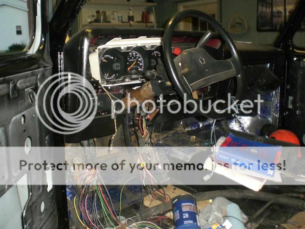

That is pretty much exactly what my truck is. Except I went black instead of gray. Here are some pictures from when I was building the truck. These are also grand cherokee power leather seats.

Thanks for the responses guys. I've been reading into it and had found the SEM paint you mentioned. There seems to be plenty of people warning against it, particularly Bonds enthusiasts. My theory is that some people try to paint the type of thin foam style dash pad like what comes in a 96-98 Grand Cherokee. The kind that mush when pressed with a finger.
Our dash caps are hard plastic. They should be easy to paint along with the rest of the interior trim. The bummer part of the deal is that I have to remove my dash cap and fix it. It has developed cracks across its width in several areas. I know I could fix them easily with the cap in place but that will not stop future cracking, which will look crappy when they happen and F up the new paint. My plan is to pull the cap and glue a few pieces of something underneath it across its length to make it more rigid. My truck tows up harsh gravel roads almost every weekend.
