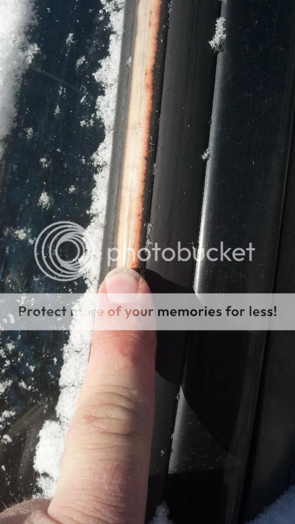

There is a rubber locking strip that goes in the middle of the gasket. Pull it out and cut the gasket out.

Yup, it's a round strip of rubber about a 1/4" in diameter.
I have seen another style on equipment that there is no strip, but 1 side of the gasket lays on top of the other. To seal it you force the longer side into the groove which pushes both sides tight.

Ok cool - I'll have to dig into it once the snow is gone and see if I can identify this strip. Assuming this strip is visible from the outside? I guess I could also just cut the gasket with a sharp box knife.

Postby dazedandconfused » Thu Jan 23, 2014 1:03 pm
The lock strip in the piece my finger is on.

My gasket is all rubber...I don't have that on the outside...what is going on with my truck?

Postby dazedandconfused » Thu Jan 23, 2014 2:36 pm
You have it but yours is just black. They all have them my last one was all black.

Diesel, take a small screwdriver and dig into the seam and see what happens when you pull it up. I have only seen the gaskets with the strip in Dodges, but it's possible it has the other style I mentioned. If the gasket is the least bit stiff, a new one well worth the money for the hassle you save on install.

Postby Diesel » Thu Jan 23, 2014 7:47 pm
Andy and toombs were right. It's there but has blended into the gasket. It's safe to tear up the zip strip and get a new one with my new windshield seal?

Postby dazedandconfused » Fri Jan 24, 2014 1:42 am
Yeap

Postby PToombs » Sat Jan 25, 2014 6:47 pm
I'd peel it out and try to save it. The new one I got was smaller diameter than the original, so I reused the thicker one so it would seal better.
