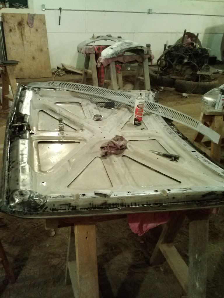

Did get a couple pieces about done tho
should get the hood done tonight

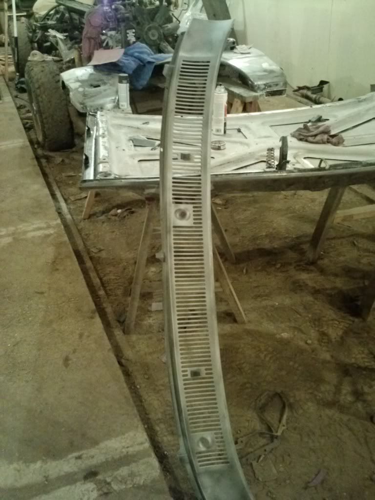

Used paint remover and then pressure washed this piece to get all the paint off

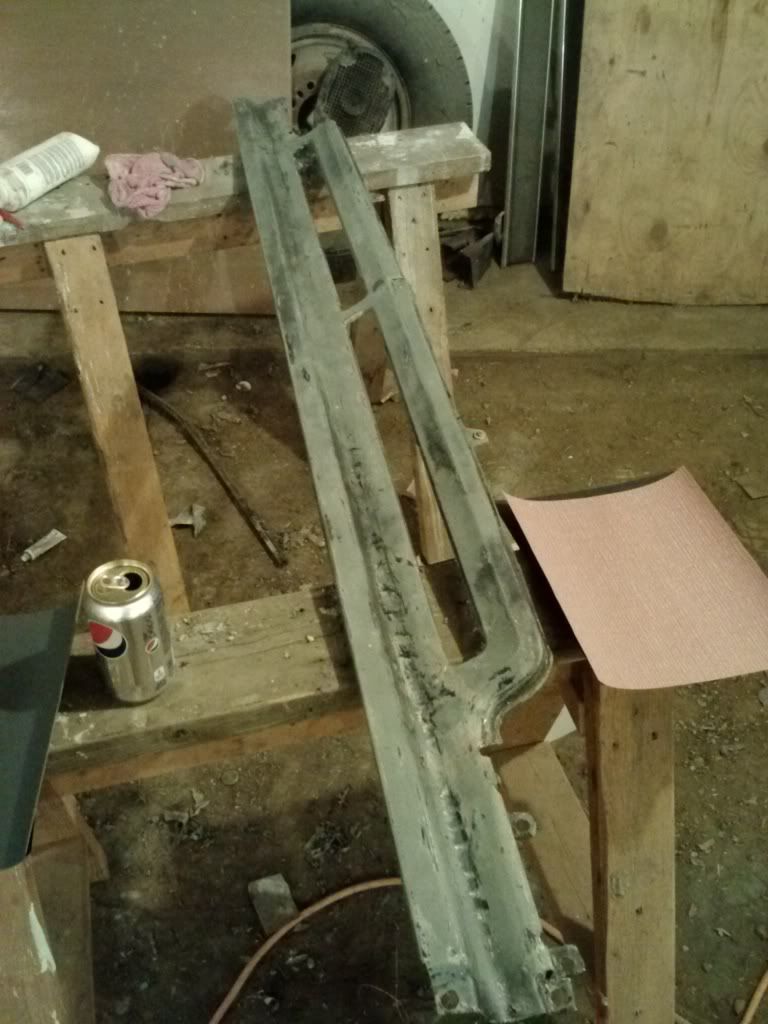

Also used paint remover on this piece. Just need to get it sanded down a little bit.
