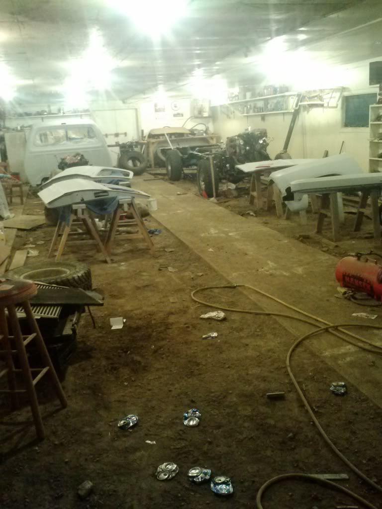

Postby Hansen01 » Thu Aug 01, 2013 5:53 pm
I could use some more crap laying around :lol:
Re: Hansen's build thread
Postby PToombs » Thu Aug 01, 2013 6:20 pm
From that pile on the floor I'd say you're working on the wrong sheet metal! :lol:
Postby RCCUMMINS89 » Thu Aug 01, 2013 9:41 pm
So, when's this thing going to be back together?
Postby ihredneck » Fri Aug 02, 2013 4:14 am
What'd that area used to be for? Kinda looks like free stalls?
1999 RCSB 1500 24v NV5600
2000 VW Jetta TDI
ihredneck
Posts: 308
Location: Missouri
Postby cmann250 » Fri Aug 02, 2013 4:36 am
ihredneck wrote:What'd that area used to be for? Kinda looks like free stalls?
Farrowing house
Postby 1STGENFARMBOY » Fri Aug 02, 2013 12:17 pm
this is just me but, before I started blowing color I would at least put down some plastic on the floor, when paint goes on
it's like it's electric charged and the dirt is attracted to it, it will help keep out some of the dust.
also when you pick the spot your gonna shoot if you can put a box fan on the floor blowing out of your "booth"
the then somewhere up high in the opposite corner cut a hole and put some furnace filters, this will kinda make a
down flow is will suck the floating dust down to the floor instead of up in the air.
the more fans you have blowing out and the more filtered air coming in the better.
Postby Hansen01 » Sun Aug 04, 2013 8:03 am
PToombs wrote:From that pile on the floor I'd say you're working on the wrong sheet metal! :lol:
:lol: It happens
Dont worry,i am not painting it in there :lol:, Im taking it into town to a paint booth
I was originally hopeing to have it done by september or so, cause that is when the last truck pull is, an its in my town, but our local body man is so slow and busy that i dont know if that will happen or not.
