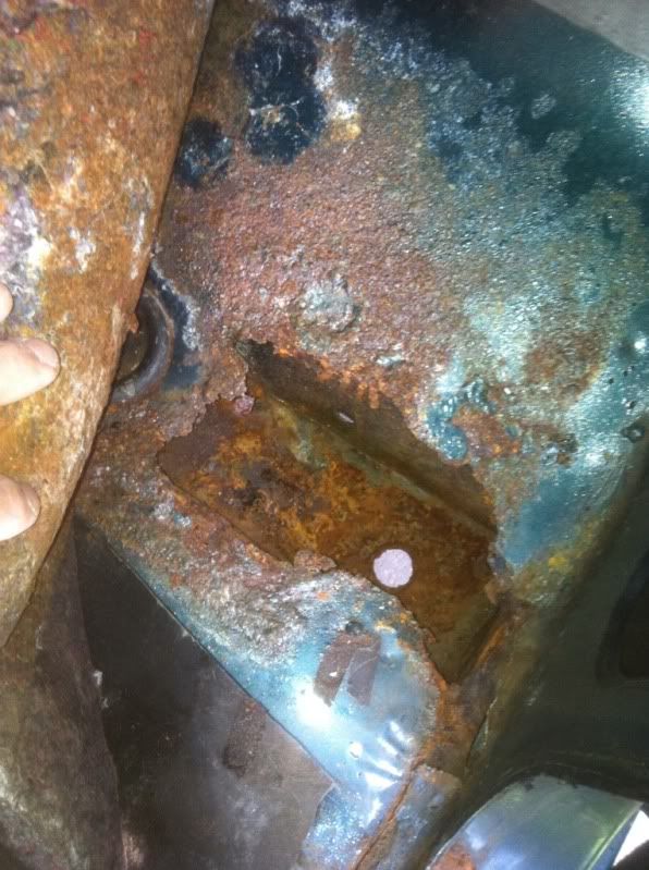

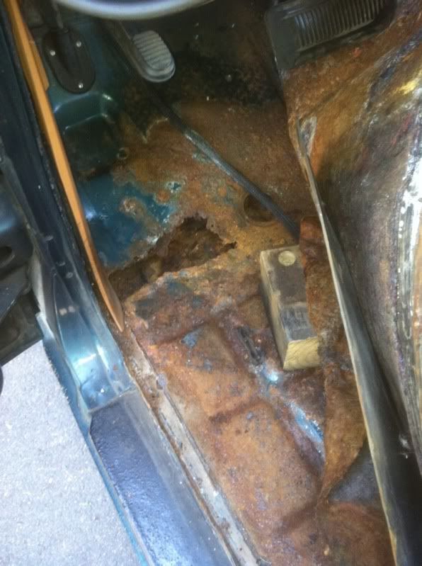

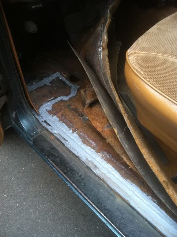

Well I decided to pull back the carpet a little today and tackle a little rust issue. I had noticed from underneath that the outer floorpans had become rusty and were seperating from the inner rocker. I had only planned on welding in some angle iron from lowes to reinforce it, and was just pulling back the carpet to keep it from burning...
Well, here is what I found! Welcome to new england... this truck is my daily so I decided to micky mouse it a little to try and hold me over a little untill I can someday afford a 2nd gen
Well i had to get out the die grinder and start nibbling away to try and find some semi-solid metal

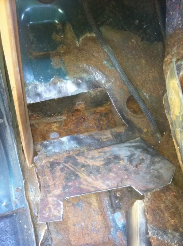

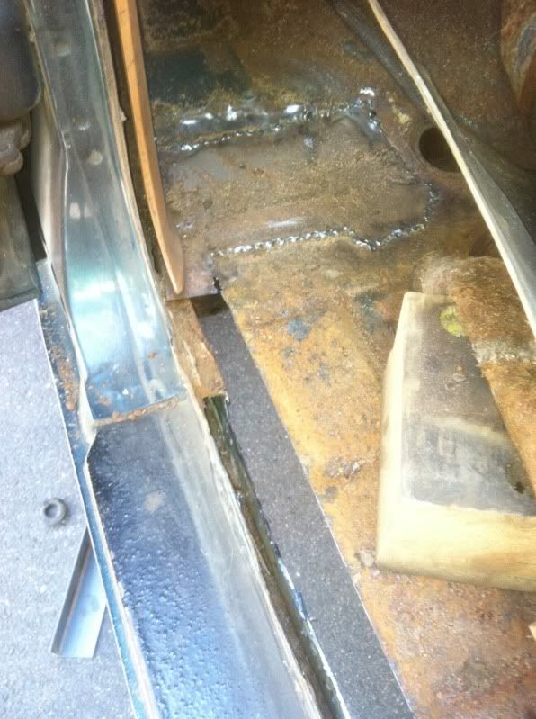

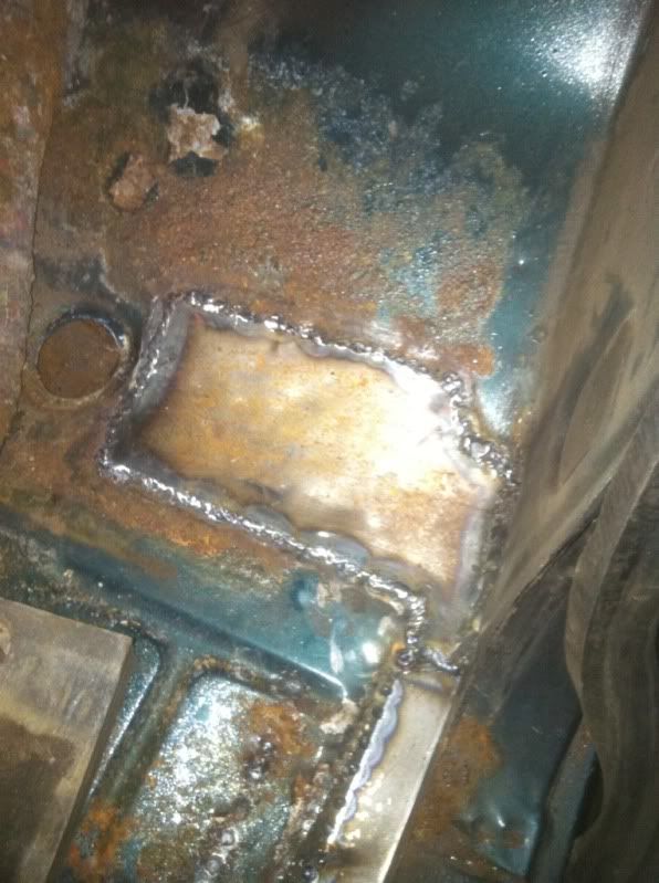

This was the quick patch I made up for it...

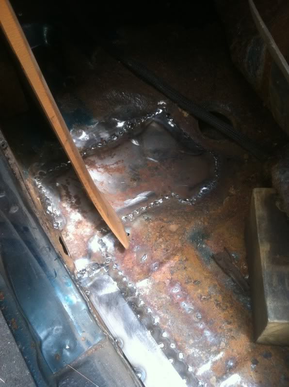

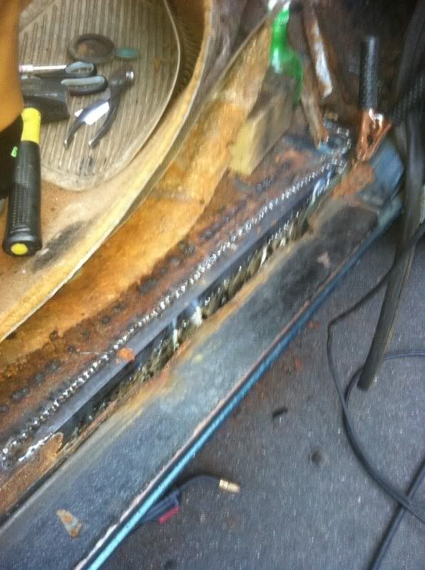

Then I moved on to welding the angle iron into the corner of the floor to give it back support...
Here is the top view...
I also went and got some smaller steel pieces, because the strip where the screws go from the sill plate just about fell out too, and I decided to put a piece of metal to simulate the pinchweld for the weather seal. I decided not to tackle the outer rocker yet, maybe at a later date. Noone really steps on that, and the door seal will hide most of it.

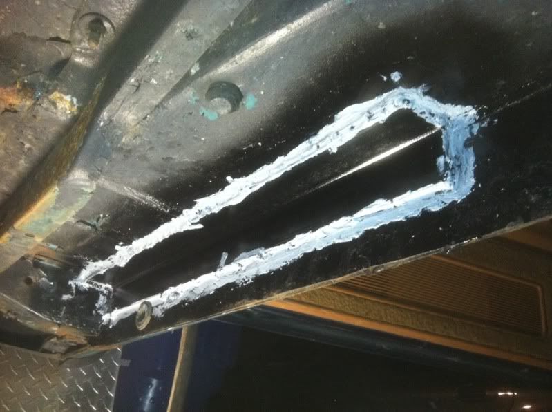

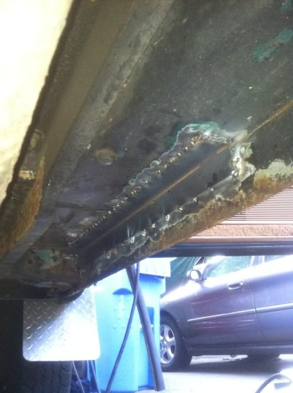

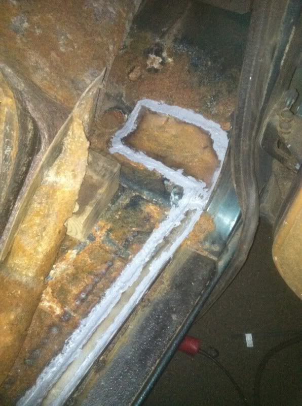

Here is it seam sealed and ready for paint...
And the bottom ready for the 2nd coat of paint...
Tomorrow I gotta get up early and see what the driver side has in store for me... hope its not much worse!

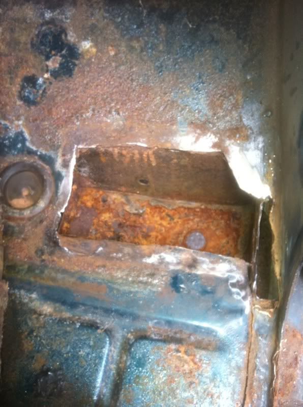

Postby slow_90firebird » Sun Jun 05, 2011 5:29 pm

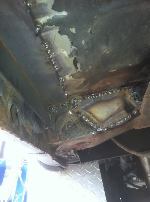

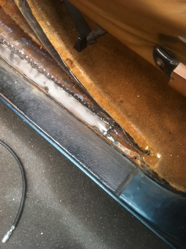

Well got up this morning expecting the worst... and found it :lol:
This sides floor was rotted a little worse, but the inner rocker and pinch were a little better. Still not great for welding too, but I made done with it (that what seam sealer is for) oh and there was a hole in the boxed section I plated in too...
Heres the pics its pretty self explainatory:
