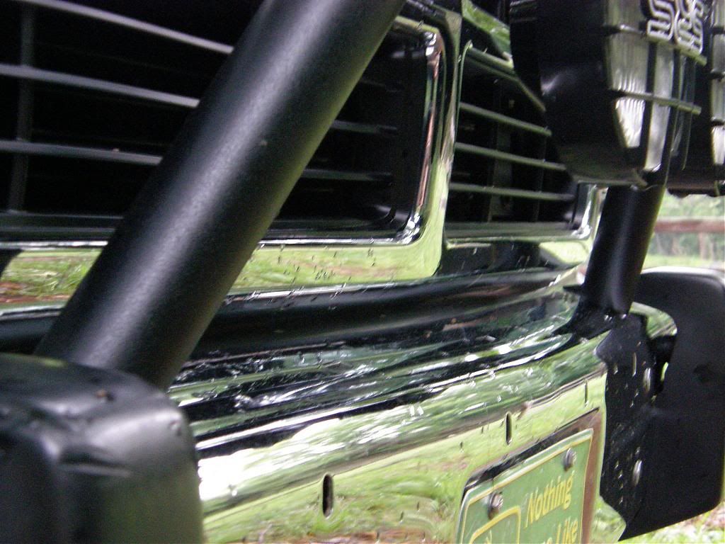

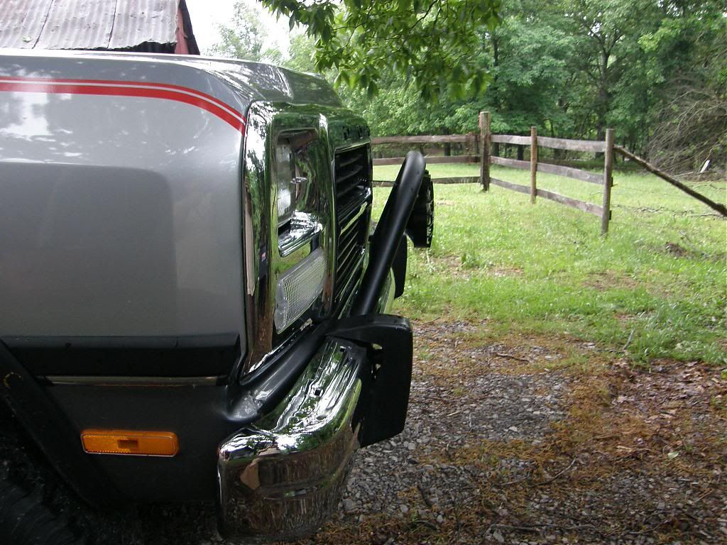

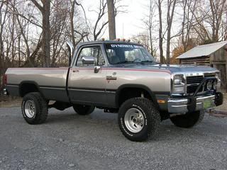

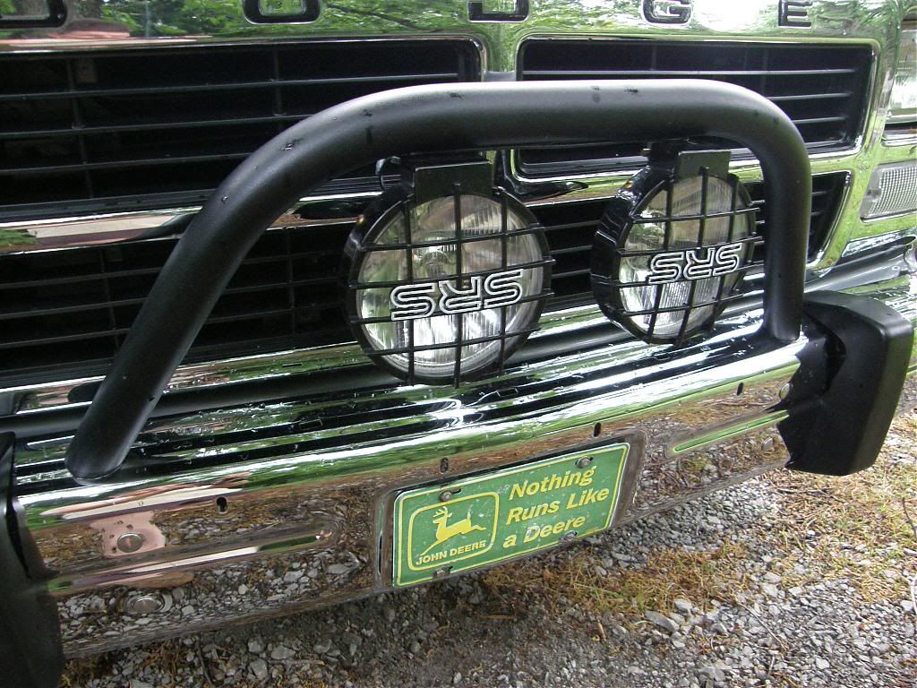

Postby 1STGENFARMBOY » Thu May 13, 2010 1:16 pm
I'll give it to ya right cheer.
I have some more on my home computer, I'll post them when i go in tonight it could be
late, this time of year is crazy for me i usualy don't eat supper till 9:30 or so. well crap
you can bearly se it, sorry.I'll try somthing els.
Re: Bull Bar/Front light Bar
Postby 1STGENFARMBOY » Thu May 13, 2010 1:27 pm
ALRIGHTY THEN lets try this
lets see how this does. i can give you some specs if you want.
Dar

Postby PToombs » Thu May 13, 2010 5:46 pm
Hey Dar, fine looking truck! 8)

Postby 1STGENFARMBOY » Fri May 14, 2010 5:06 am
Thanks guys, i'm not to shure i like the windshield sticker but the wife got it for me so i
need to leave it on for a while. :roll: The bar is coated with the spray can bed liner, i warmed
it up in the oven at work but you could use a torch and that stuff works good.

Postby Bouts » Sun May 16, 2010 7:59 pm
A little information on how you made and mounted that bar would be appreciated!! I think it looks real good! Is it through the bumper??

Postby 1STGENFARMBOY » Sun May 16, 2010 8:42 pm
It's a piece of 2 in 3/8 wall tubing, after i fited it buy grinding and trying a few times till i got it right i
welded a big thick washer with a stud inside the tubing that goes through the bumper useing the factory holes that are
for the bumper cover, then i went under and made a bracket that bolts it to the frame using the same
studs, because it was alittle floppy, hope i made that where you can understand it. :roll:
Dar
Postby Bouts » Sun May 16, 2010 8:50 pm
You did, and I do!!! lol Thanks, looks real good!! Been looking for something a little different to mount my driving lights, I may have found it!!!! Nice job for sure!
