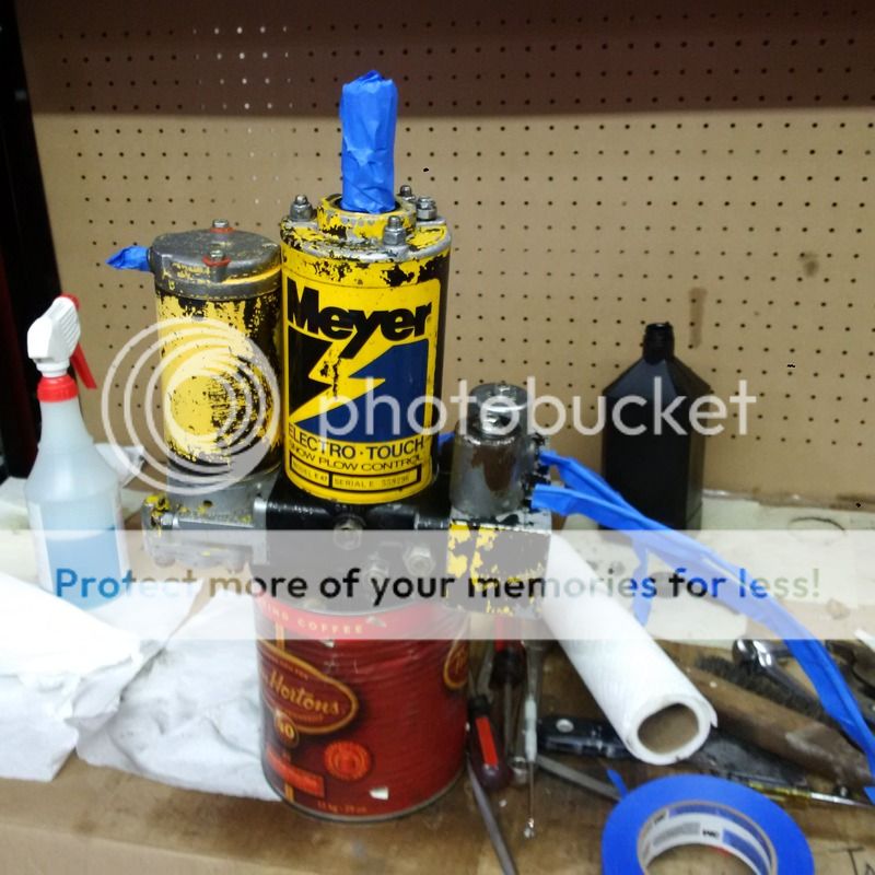

Went to the local auto parts store and bought a can of engine paint that looked close to the original yellow. Got it pretty close....looks much better.
Replaced the trip springs....they were looking a little rough.
And some new lines and fittings.
