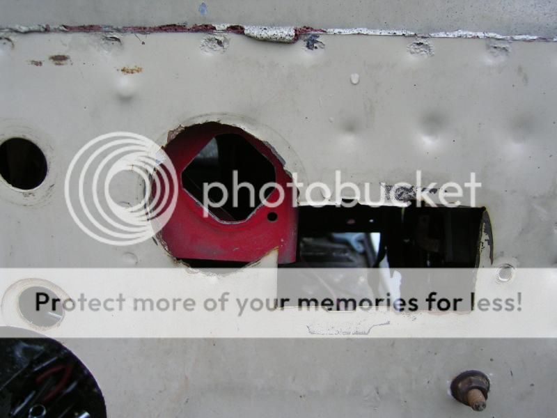

Postby thrashingcows » Mon Oct 06, 2014 10:52 pm
I just rat filed the wiring bulkhead opening over, then welded in some small pieces to take up the space the old wiring bulkhead used to occupy. Then measure and drill for the clutch hole.
Mine was thoroughly butchered before I got my crew...so I was only making it better. ;)
Here is a before and after pic....
