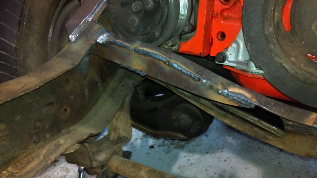

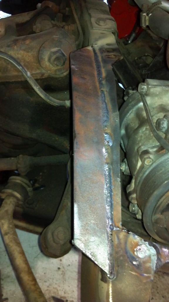

Postby ellis93 » Tue Jun 25, 2013 2:09 pm

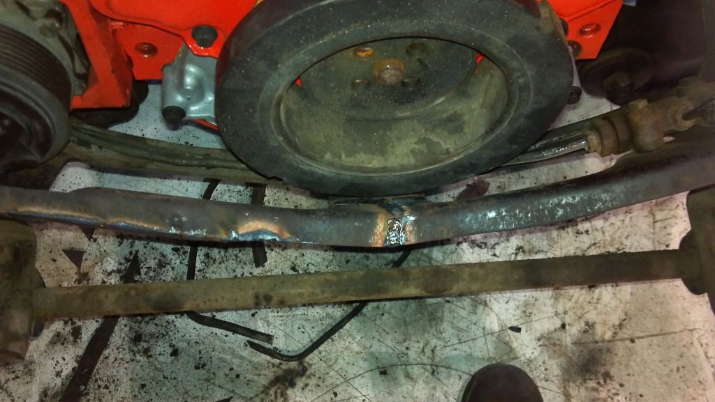

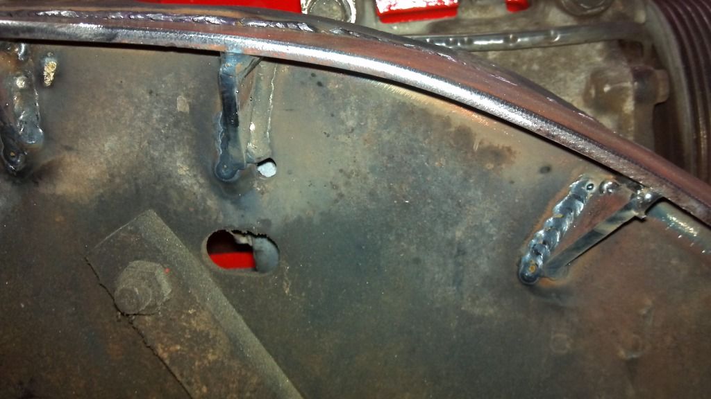

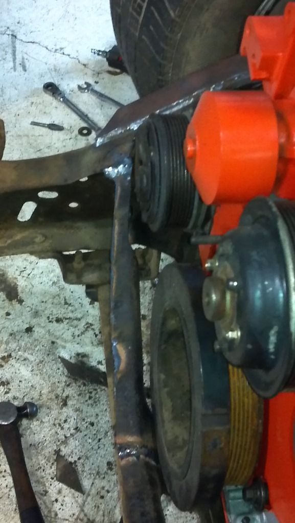

Started cutting on the frame to fit the a/c in
Added some flat bar in on that chicken crap crossmember to stiffen it backup after thining it down
Everything is real close
I'm in the middle of fitting the rad and cooler/AC condenser assembly in the core support. It's not fitting :( it'll be cut to hell before I'm done with it.
Fan will not be used either....theres about 1/4" between the rad core and fan clutch,too close for my liking.

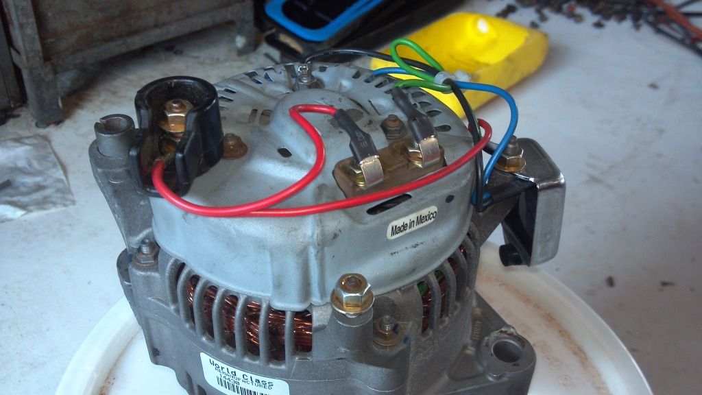

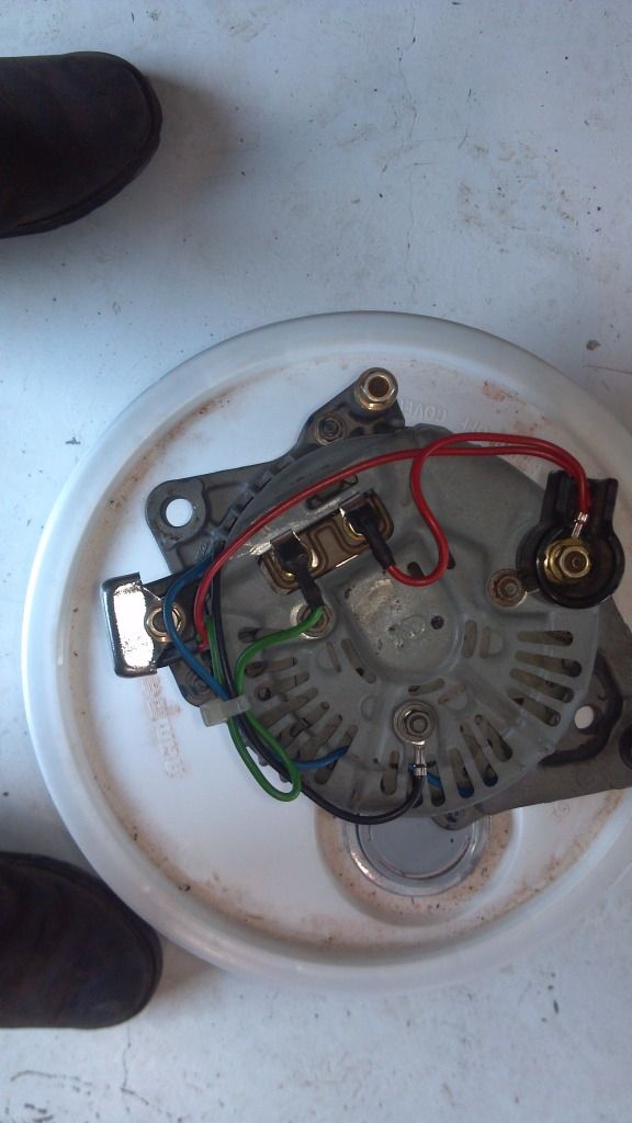

I did get my alt back today....the reg and new pulley (old had 7groove instead of 8) cost me 62$. It is charging at 14.5v and puts out 135amps. That ought to work :lol:
As promised...pics and part number
Dude told me that the brand name was register and that's his scribble on the paper so....take it for what it's worth.
Re: Cummins/82 C10
Postby PToombs » Tue Jun 25, 2013 6:17 pm
Is that the number of the regulator widget? I see a number on the alternator, it's a World Class #14430.

Postby ellis93 » Tue Jun 25, 2013 6:58 pm
Pete...that's the number for the regulator
