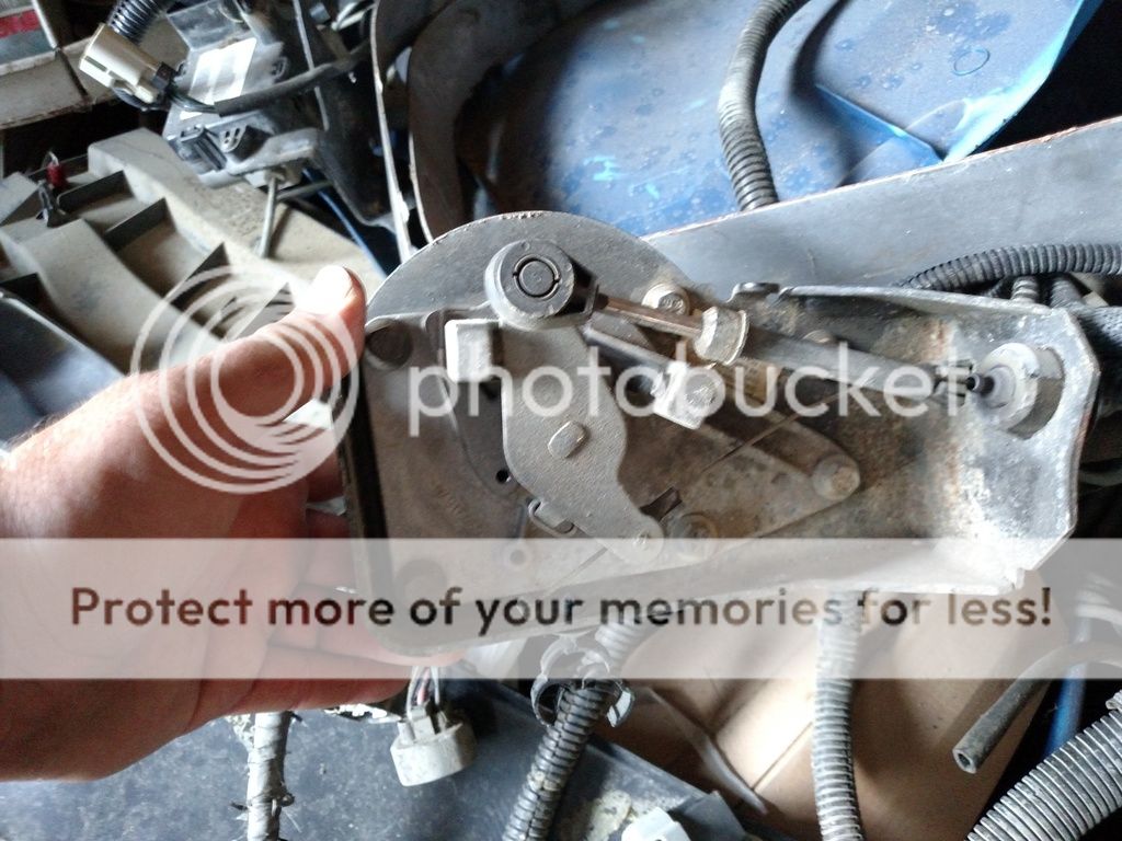

What all did you have to do to run the VE pump on the 24v? What parts needed to be changed?
Re: Cummins/82 C10
Postby ellis93 » Sun Aug 23, 2015 1:19 pm
Pump,gear,case,cover,threaded inserts/turn into adapters,and some sort of rigged throttle assembly

Was the truck that gave up the 24v an auto Ellis? I'm looking for a couple pieces and didn't know if you still had any of the stuff if it was an auto truck.
Re: Cummins/82 C10
Postby ellis93 » Fri Sep 04, 2015 8:43 am
It was Andy,and I still have it at the shop
Re: Cummins/82 C10
Postby dazedandconfused » Fri Sep 04, 2015 9:14 am
I need this bracket for an auto VP truck and a lockdown cable.
Re: Cummins/82 C10
Postby ellis93 » Fri Sep 04, 2015 2:17 pm
I'll have to look for the cable,the bracket I have but I was going to save the tps. Do you need the tps?
Re: Cummins/82 C10
Postby dazedandconfused » Fri Sep 04, 2015 2:24 pm
ellis93 wrote:I'll have to look for the cable,the bracket I have but I was going to save the tps. Do you need the tps?
I don't know if there is a difference in the tps between manual or automatic. My bracket doesn't have the spot for a lockdown cable.
Re: Cummins/82 C10
Postby ellis93 » Fri Sep 04, 2015 3:31 pm
Any I've changed looked the same so I'd say your good. I'm in Tennessee right now but when I get back to the shop Monday I'll look for the cable.
Re: Cummins/82 C10
Postby dazedandconfused » Fri Sep 04, 2015 4:06 pm
I'm in no hurry just whenever. Thanks Ellis.
