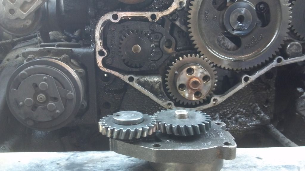

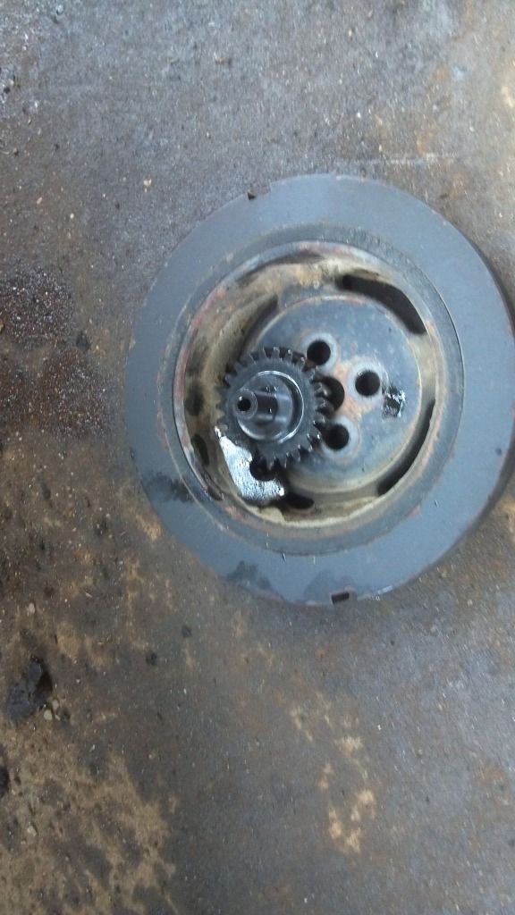

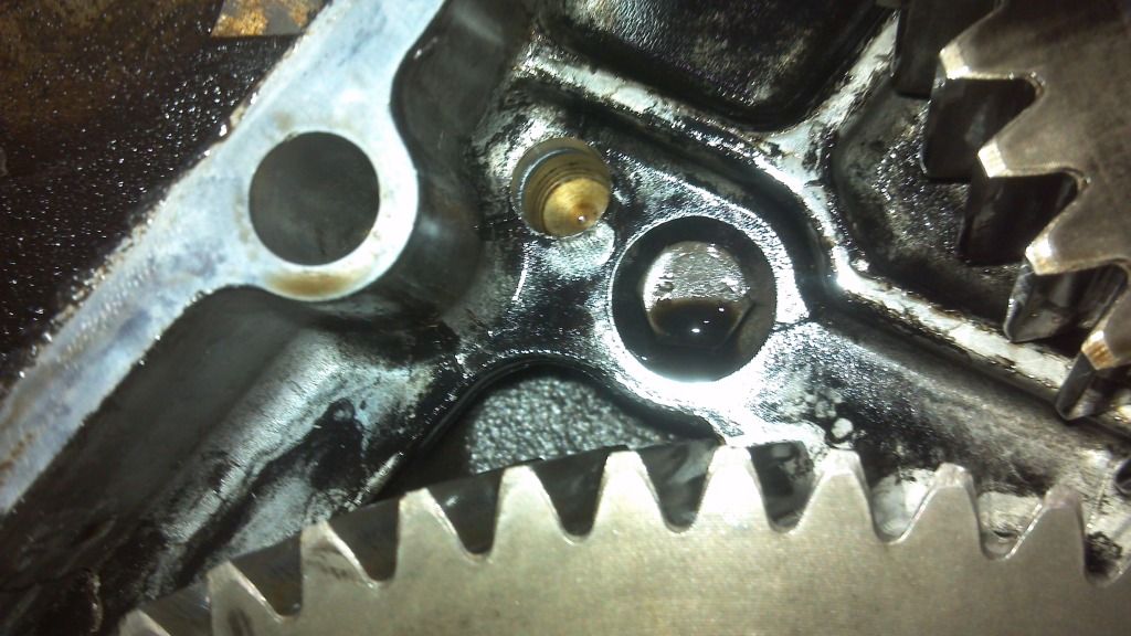

Well got to the shop early this morning and had two choices....install injectors in the dodge or solve the oil pump mystery on my conversion engine. I chose the mystery :lol:
Huh oh
Oh no
Damn dowel pin doesn't digest well :(
Looks like I'm tearing the engine down,probly just welding up the case and installing Mains/rod bearings just because I'll be there.

Re: Cummins/82 C10
Postby RCCUMMINS89 » Mon Apr 01, 2013 8:25 am
Ouch
Re: Cummins/82 C10
Postby ellis93 » Mon Apr 01, 2013 9:39 am
Tell me about it :lol:
Guess I may just put it back together just to see how the bottom end is,got a pump and might as well

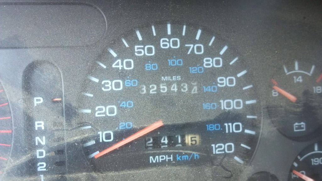

Re: Cummins/82 C10
Postby dazedandconfused » Mon Apr 01, 2013 9:48 am
How many miles are on it? Never seen the KDP kill an oil pump.
Re: Cummins/82 C10
Postby ellis93 » Mon Apr 01, 2013 10:03 am
A moderate amount :lol:

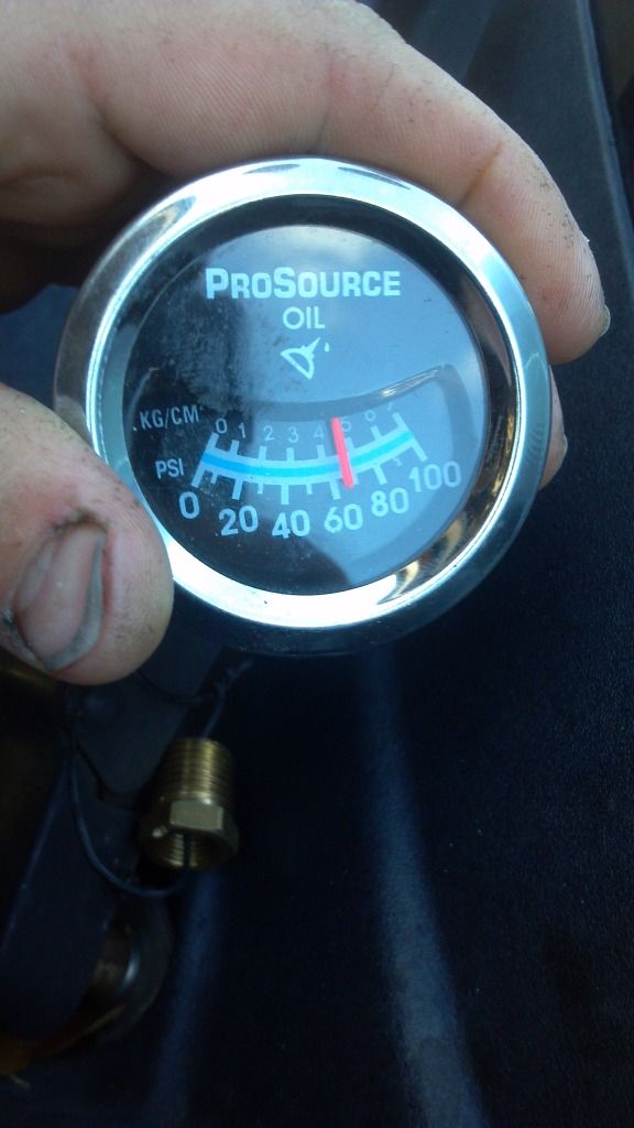

Re: Cummins/82 C10
Postby ellis93 » Mon Apr 01, 2013 10:50 am
Success! 70psi of oil pressure :mrgreen: yeah me. Image

Re: Cummins/82 C10
Postby RCCUMMINS89 » Mon Apr 01, 2013 11:04 am
Hell ya.... I'd say run her until she has to be rebuilt.
