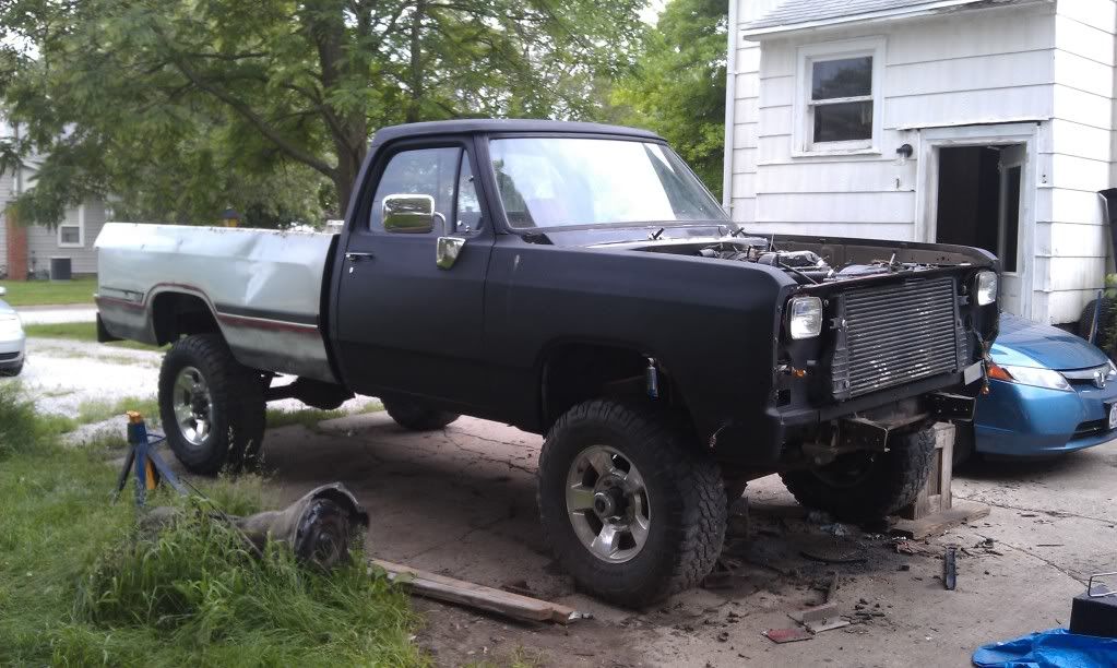

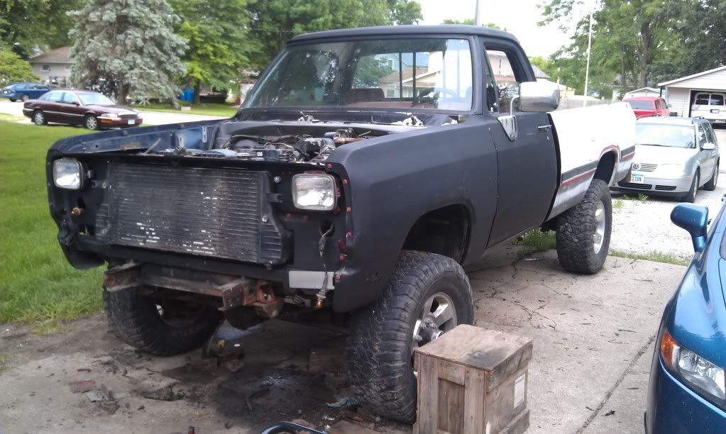

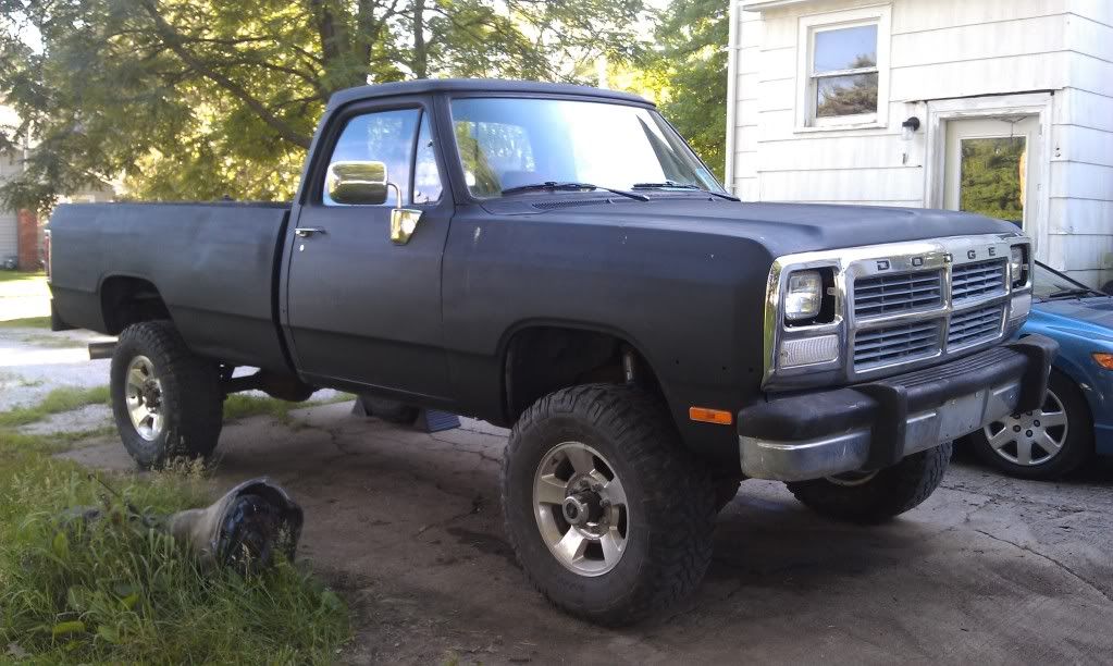

Progress? Pictures? Yes and Yes!
Well, it runs, drives, steers and stops. Still got a lot of small stuff to finish, needs a stronger clutch as it pushes right through the one that's in it now, need to get the rear Kelderman single bag on, get the interior put together and speakers put in. Took it to town today, idle screw lock nut backed off and the screw went waaaaay in, good thing I had a handful of tools and some wire, got it turned to where the thing would idle decent and wired it in place to get back home. Got a weird fueling issue, when I let out of the throttle, it will chug down so low it almost dies, then pops right back up to proper idle speed. The more I turn the fuel screw in, the worse it gets, so bad that when I snap the throttle open, it'll chug down and die. Any suggestions?

Postby Mark Nixon » Tue Jun 18, 2013 8:42 pm
CumminsPower59 wrote:...Any suggestions?
Yes!
Mow your grass and pick up your parts! :lol:
Anyone who's been here won't recognize the place now. :roll:
Glad to see you're making progress after your "logo addition".
Postby PToombs » Wed Jun 19, 2013 5:31 pm
I think you missed a step! The trans is sitting on the lawn! :lol: Looks good Ike, now to drive the siht out of it! ;)
