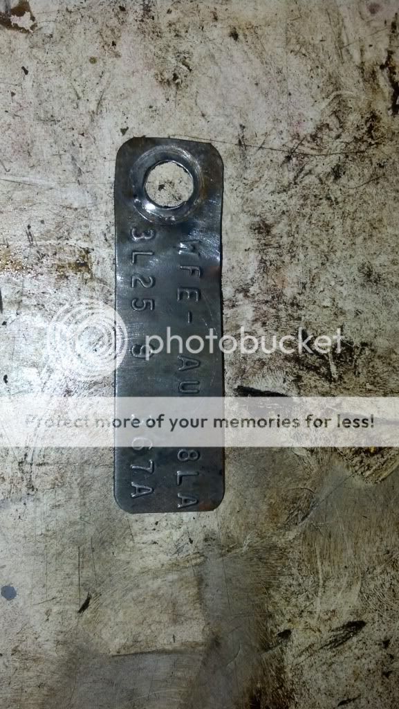

Postby dazedandconfused » Sat Feb 23, 2013 2:24 pm
Went to the pull-n-pay today and picked up Ford 9" for $100.
Can anyone decipher this code tag?
Re: Project ugly duckling
Postby PToombs » Sat Feb 23, 2013 2:34 pm
Yup! It translates to "ruins dodges on contact!" :lol:
Postby CumminsPower59 » Sun Feb 24, 2013 2:17 pm
Andy, its a 3.25 gear with a factory locking diff...
I got the info from here...http://www.fordification.com/tech/rearends_ford07.htm
Postby dazedandconfused » Sun Feb 24, 2013 2:21 pm
Thanks Ike I figured out yesterday it was a 3.25 LS which im glad is 31 spline as well.
