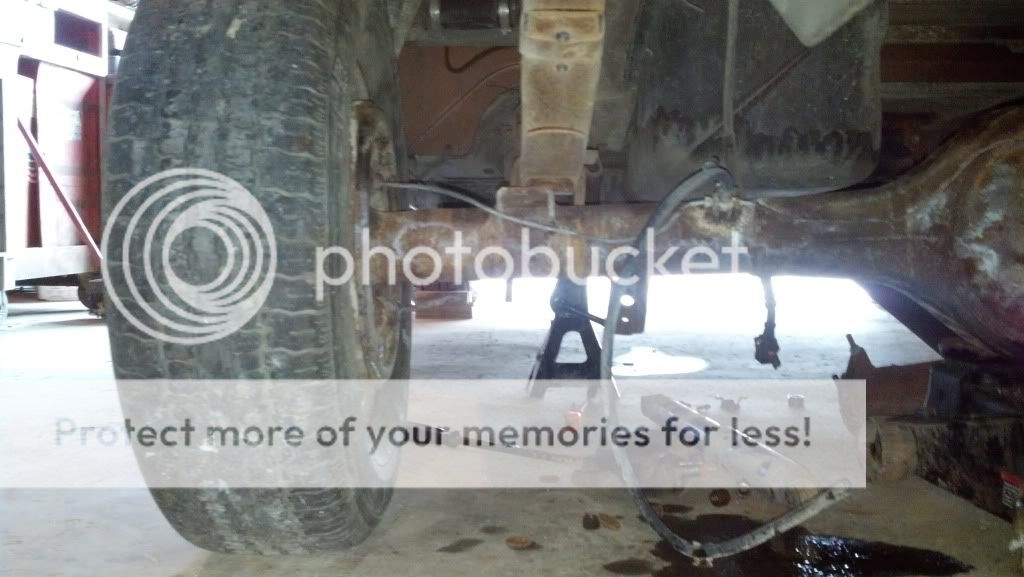

Postby dazedandconfused » Sat Apr 06, 2013 3:35 pm
Well I worked on the old girl today.I pressure washed the 9 inch and reassembled it all. Pulled truck in the barn and started teardown on it. I'll have to move the perches and wondering if I should go ahead and move the springs since I'll have to narrow the rear to fit my big tires.

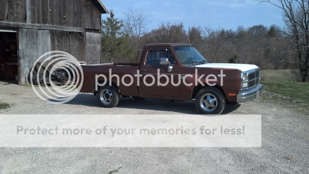

Re: Project ugly duckling
Postby dazedandconfused » Sat Apr 06, 2013 3:40 pm
So that's where she sits. I'm going to try and wiggle the rear end around and see if she will work. I spent all morning cutting up trees and hanging with my daughter.
Postby dazedandconfused » Sat Apr 06, 2013 8:13 pm
Went out and messed with it some more and got enough give to seat the rear end each spring pack moved over about a 1/4" so I'll probably run it like that for now. Plan to move springs under frame rails anyway so I can narrow the rear about 2" on each side later to tuck my big tires.
Postby dazedandconfused » Sun Apr 07, 2013 8:13 am
So got everything bolted in this morning except driveshaft and brake lines.
