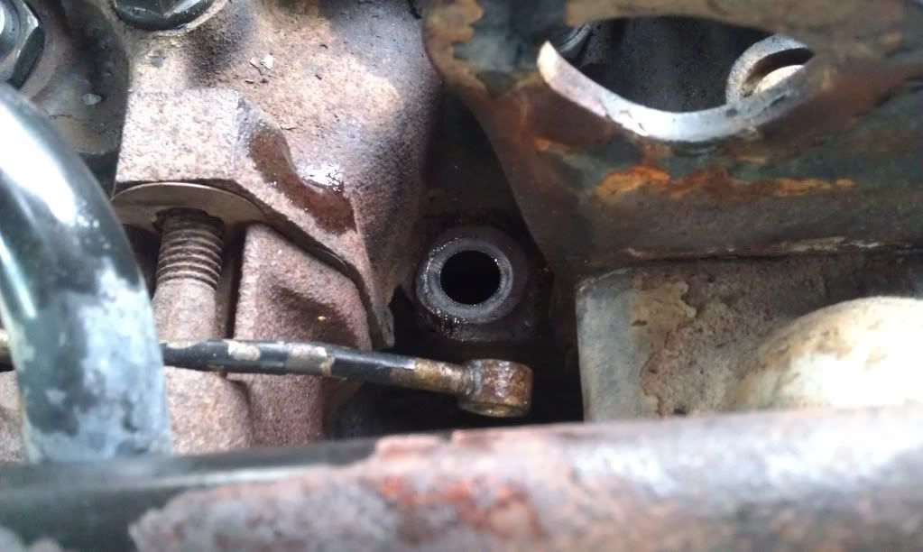

Well, so much for pulling up the head bolts. Got to number 22 in sequence, snap! What now? :mad:

My inner cheapness says pull the head, fish that busted bolt out, clean the block and head surface, slap a new head gasket and bolts on and go...buuuut, I really want a new head, studs, etc...

Damn, my inner cheapness said torque the ones around it extra-tight and run it until there's a problem. :lol:

Taco, I torqued all of them up to 125, except the one betweem cylinder 2 and 3, it kinda got tighter then kept turning, so I stopped. I'm sure I pulled the threads on that one...

Put a new head on an old bottom,when the other is working fine? Not me :lol:
I'd find bolts or studs and a gasket set....then get er done

CumminsPower59 wrote:Taco, I torqued all of them up to 125, except the one betweem cylinder 2 and 3, it kinda got tighter then kept turning, so I stopped. I'm sure I pulled the threads on that one...
I'd bet you just stretched the bolt, unless the threads were boogered up previously I don't think there's any way you messed them up.

I'm hoping that is the case. I am on the hunt now for a M12x1.75 bottom tap...
