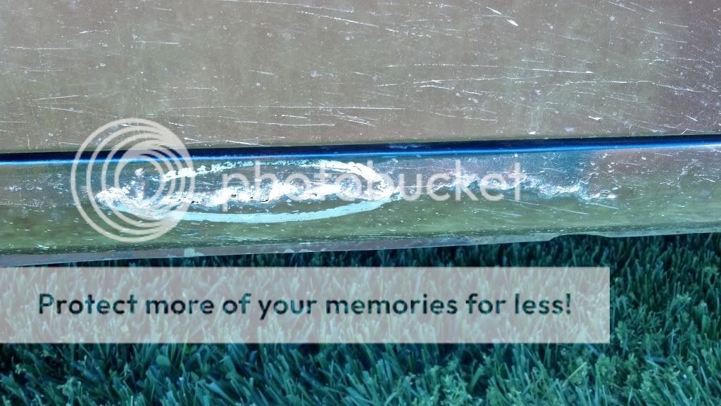

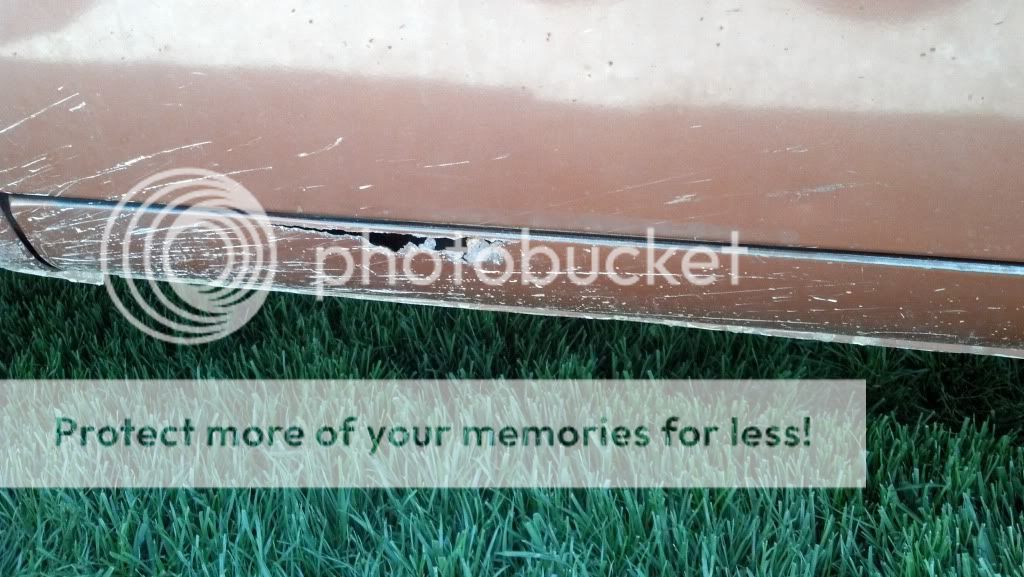

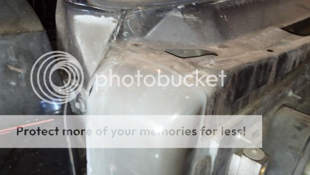

Okay so this morning when I went out to try this I found our glass garage door shattered all over my truck. My brother had a party and somehow destroyed the door. So after being able to get under it and measure again I got it together. Like RC said its a very tight fit though. Need to fix a busted brake line but she moves. Posi works too.
Re: Project ugly duckling

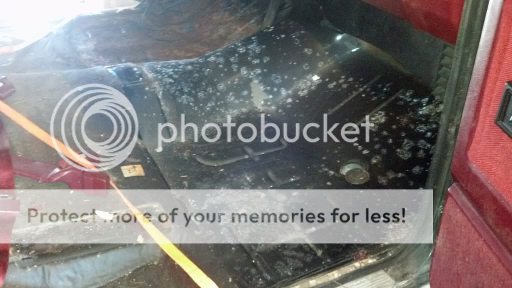

Postby dazedandconfused » Sat Apr 13, 2013 5:25 pm
This door was all glass.

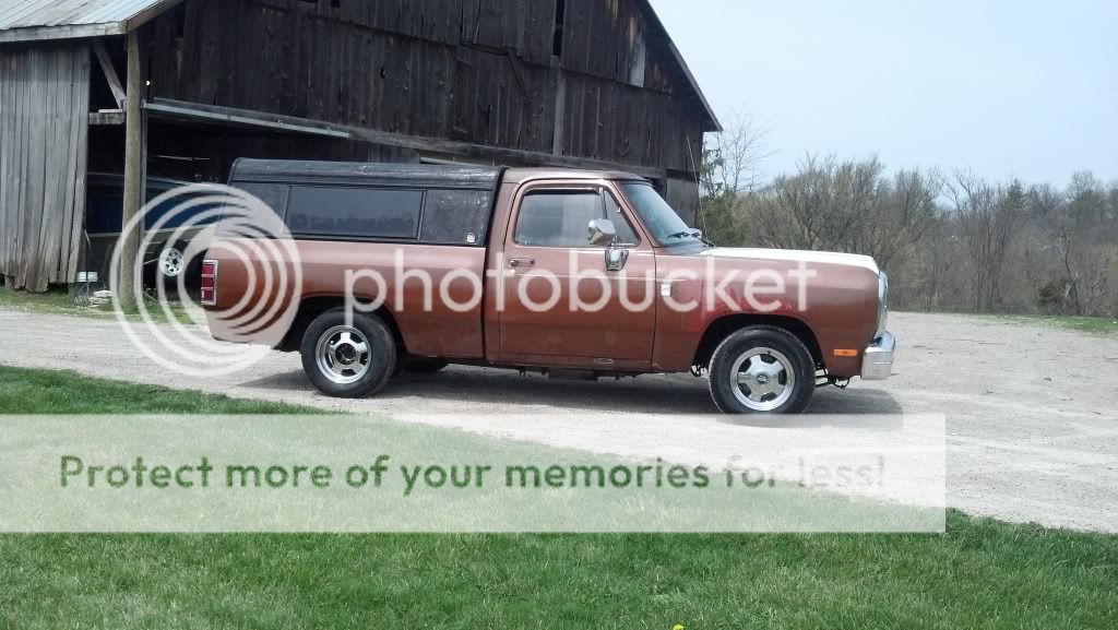

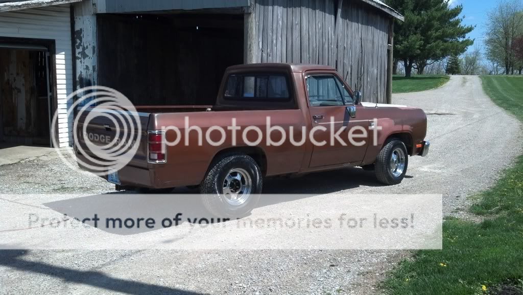

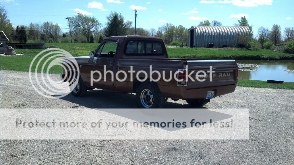

Postby dazedandconfused » Sat Apr 20, 2013 11:32 am

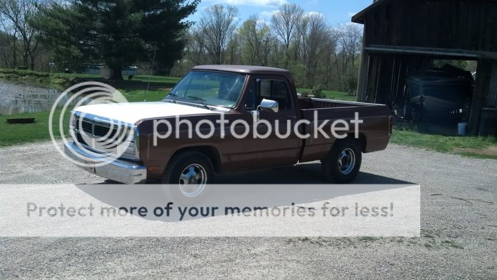

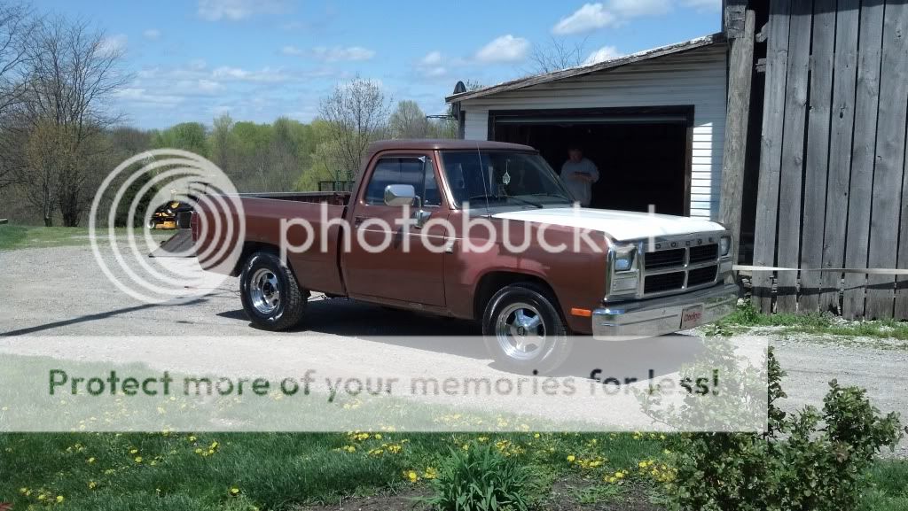

So since I sold Chris my 24V I'm back to driving the Duck. I had put new tires on the front about a month or so ago and put new ones on the back today. Rears are 31x10.50-15's and fronts are 215/75/15's. I'm running the 31's since I plan on going 31x16.50-15's so wanted to see how much I needed to lower the rear and how the gearing runs. With the 3.25 gear and 31" tires the speedo is dead nuts on according to GPS.
Postby dazedandconfused » Sat Apr 20, 2013 11:35 am
Last picture

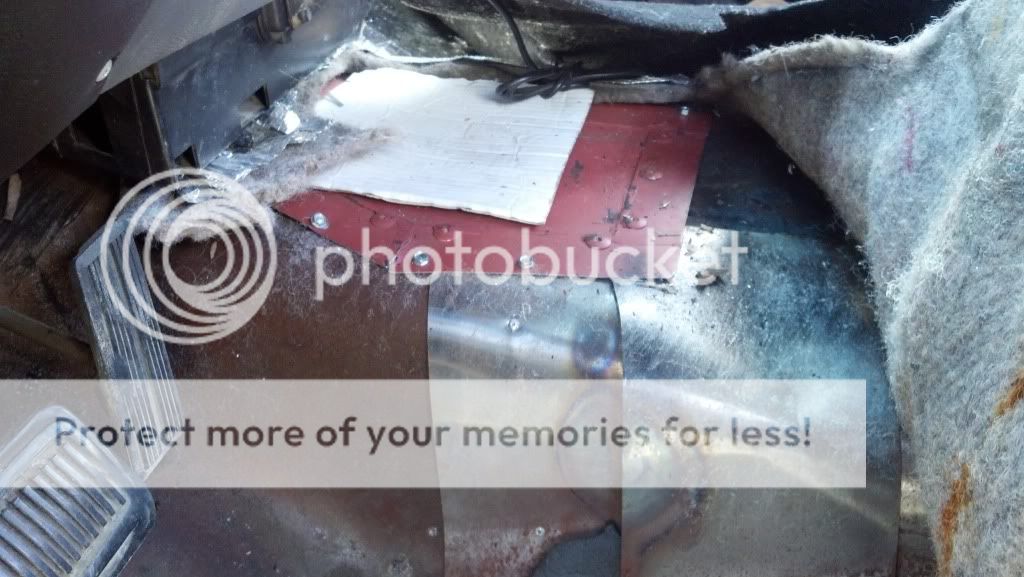

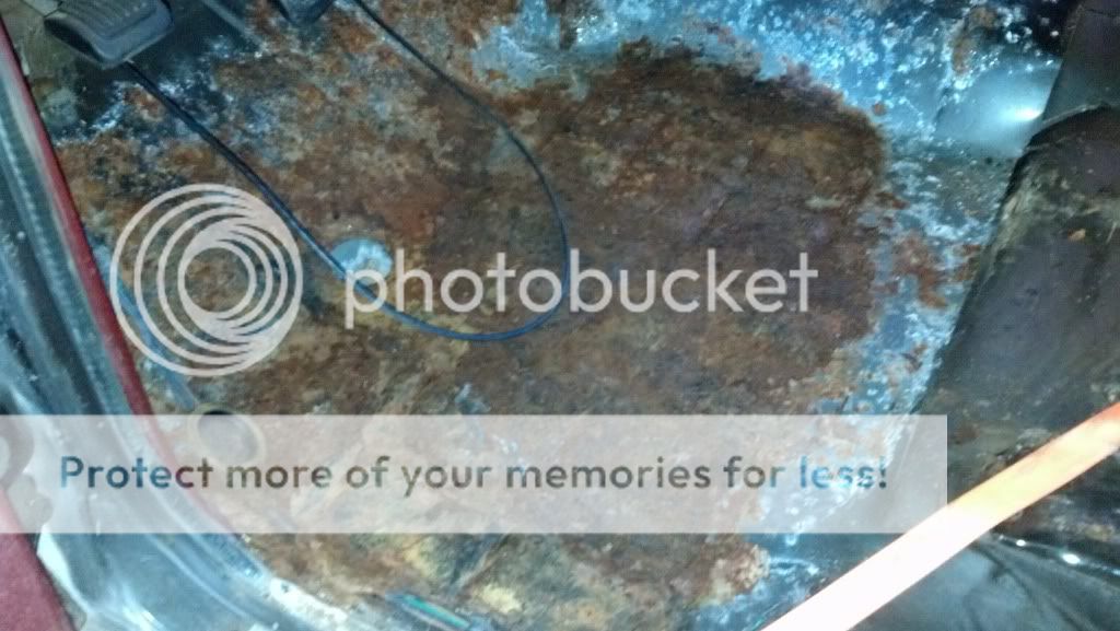

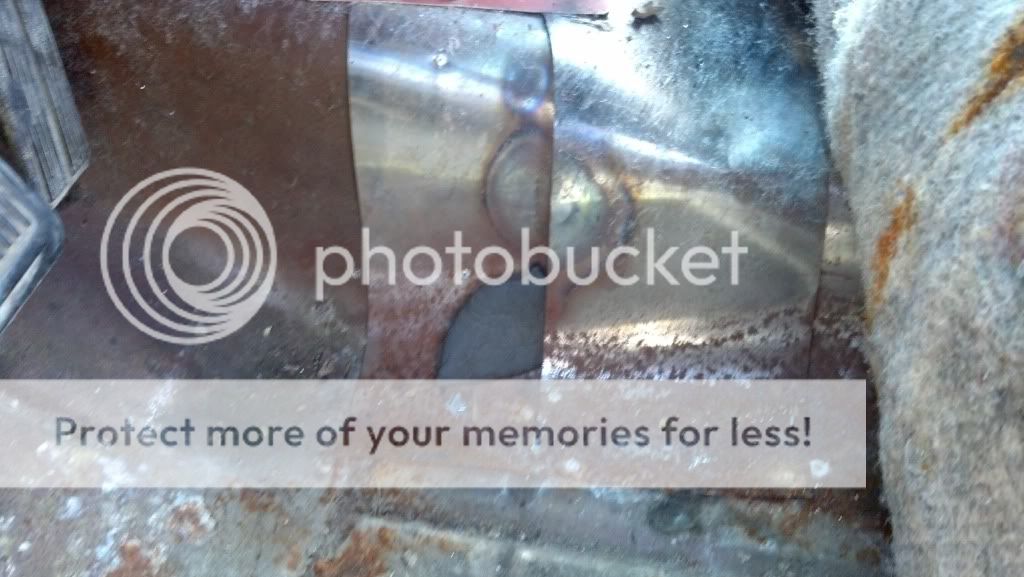

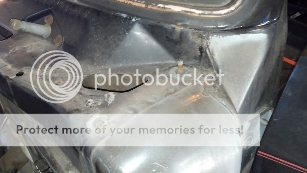

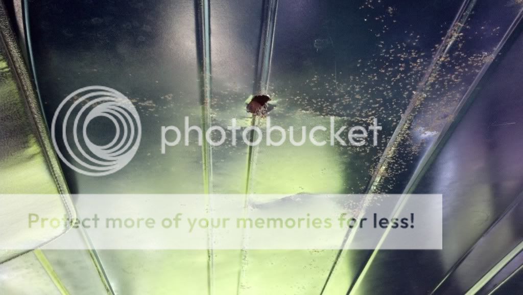

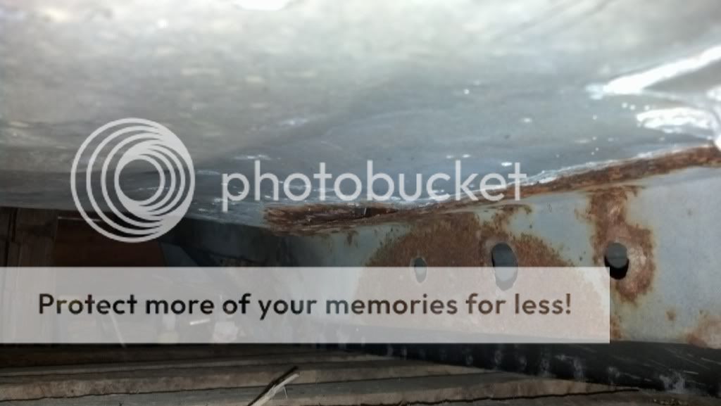

Decided to work a little on my donor cab earlier while my stomach had eased up some. I have to put a driverside floor pan in but the rest is solid.
No cracks in this one unlike mine.

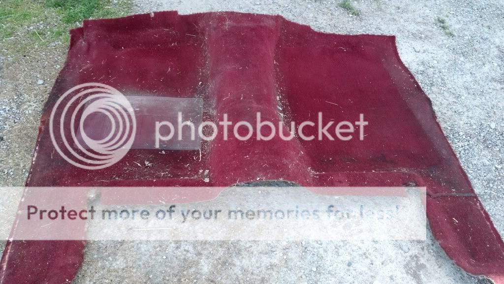

Carpet had no wear holes either.

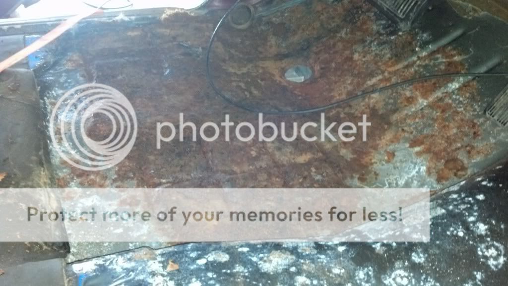

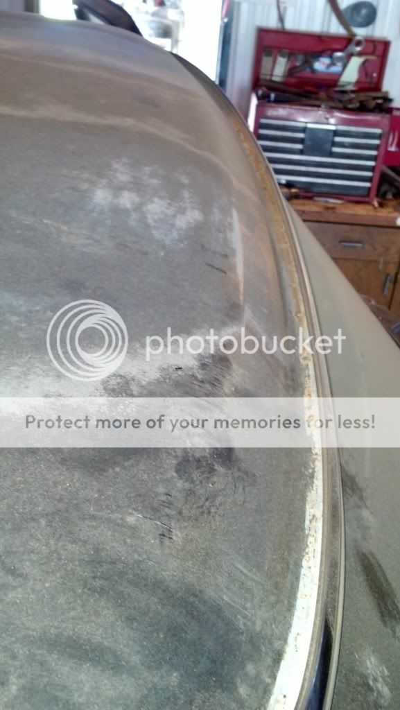

My old cab.

Postby RumbleFish » Sat Apr 20, 2013 4:43 pm
Those 31s make it look just right. I'm loving it!

You weren't kidding when you said that anything was an improvement over the cab you had. :lol:

Postby dazedandconfused » Sat Apr 20, 2013 5:36 pm
Yeah my cab is crap Caleb. The one I got from you is awesome just needs that driver side pan I was planning on it needing. I wish it was about an inch lower in the back Jeff.
