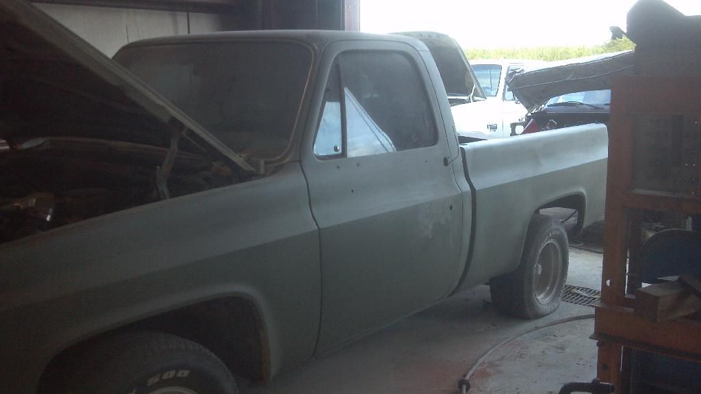

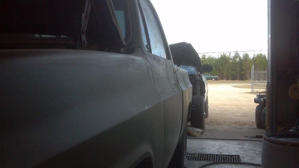

All finished with the main body
Driver side is Nice and straight....after a half gallon of bondo and lots of sand paper.

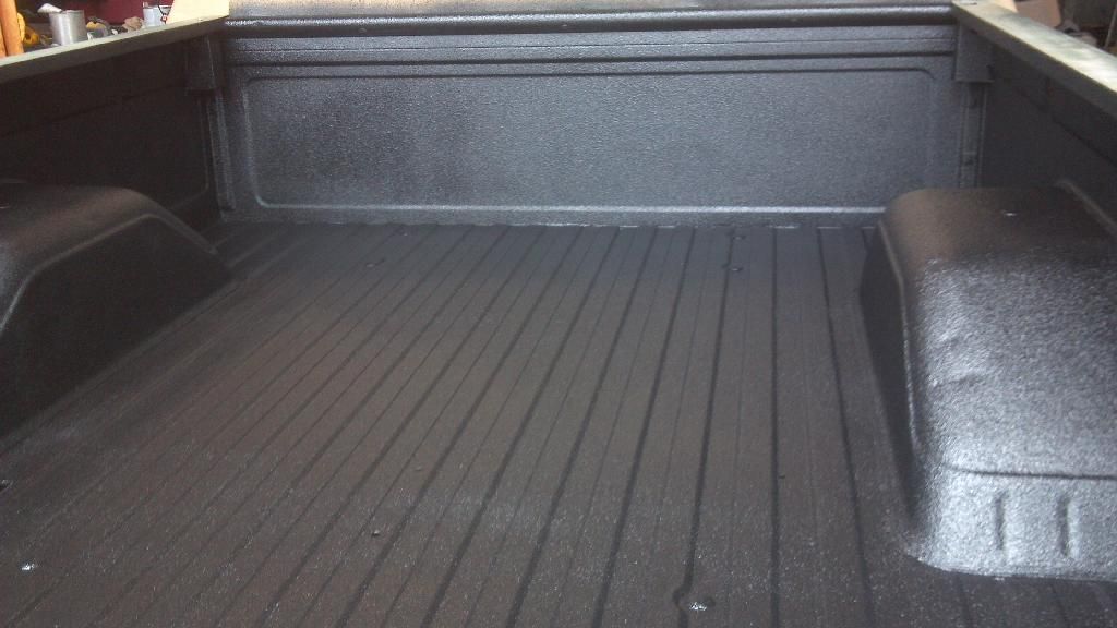

This morning I sprayed the bed with a Upol liner that I bought off ebay. It's not thick like rhino liner but not thin like that brush/roll on junk. Overall I like it. :) it covers the ugly well :lol:

Hey Ellis, wet sand the side with 600 on a small 3m sanding pad, then dry it and put a light down at one end
then get back down at the other end and look at the reflection of the light, you will be able to see just how strait
you have it before you start painting, this has brought a small ding to my attention before that I mite have missed.
it does look pretty dang good though.

Dar that is a Kit they sell for doing one bed,4 liters of coating and a can of activator.......supposedly it makes a gallon of useable coating. I still have about a qt of stuff left to do the tailgate with.
That mess is very,very easy to use. It's hard as hell right now,I've already stomped around on it measuring for new holes to route fuel line thru.
