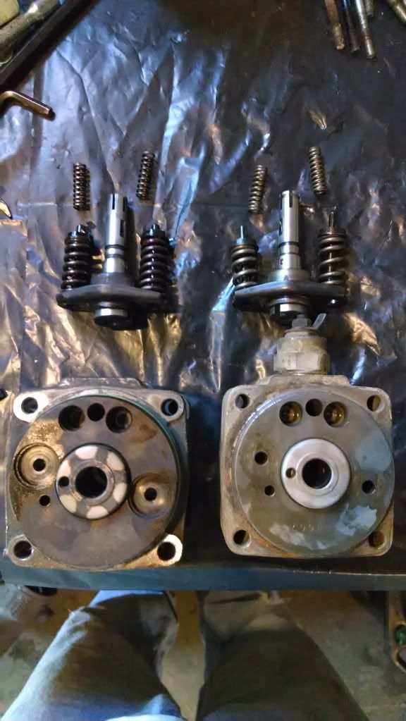

Anyways, enough for now, how about some pictures :mrgreen:
On the right is the head and rotor I put on the 114 pump..didn't know if it would work or not so I tried it anyways...
