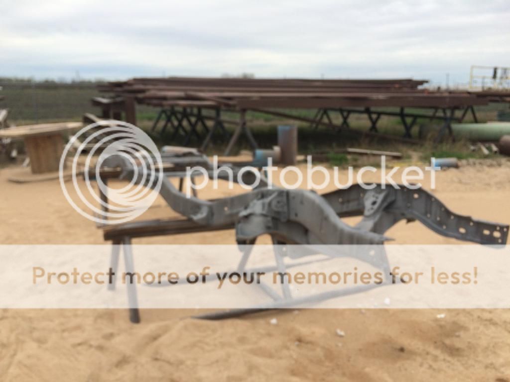

Postby Ghostman » Mon Mar 09, 2015 7:22 am
Finally I get a short window of dry weather this weekend that is acceptable for painting and sand blasting so I got after it. Took 3600lbs of #4 blast sand to get it all down to white steel. Found some more cracks on the front suspension coil bucket too. Then I sprayed it with Dupli-Color primer for bare steel. Actually was VERY impressed with the primer. It's a high build primer that is sandable and helps rust prevention. Sprayed really well, it's just not UV stable so it needs a regular type primer sprayed over it. It dryed very fast and hard. I couldn't even scrap it off after 30-45 minutes.

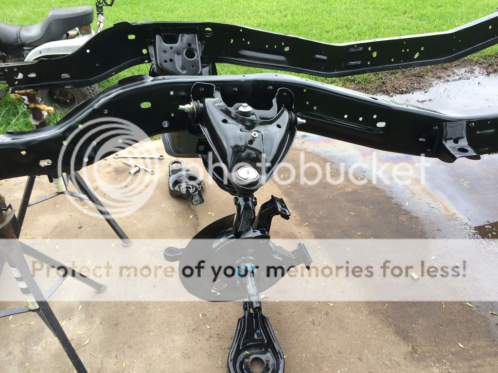

Postby Ghostman » Mon Apr 13, 2015 7:57 am
Got the frame painted and started hanging front suspension parts. Ordered a bunch of the wrong parts from RockAuto. I was past my 30 day return window but since I had a big order history with them and not many returns they agreed to take them back on store credit which I was very happy about.
The upper control arms that I ordered off ebay looked great and all except the right side had a thread in ball joint and the left side was a press in ball joint. The ball joint stud seemed a little different on each one also. I went ahead and mocked them up though and they seem like they will work although I'm not thrilled about having two different styles on it. The thread in one may get changed out on a later date. The rest of the suspension parts are powdercoated.
I still need the front rod things that go from the crossmember to the lower control arms!!
Also, I'm having trouble finding the lower control arms bushings online anywhere. I'm going to check the parts stores in town. Seems like the 4,000lb axle stuff it getting scarce.

Postby dazedandconfused » Mon Apr 13, 2015 10:16 am
Both uppers should be screw in for the 4000 pound axle. The lower ball joint bushing should be Moog K7065

Postby Ghostman » Mon Apr 13, 2015 10:52 am
dazedandconfused wrote:Both uppers should be screw in for the 4000 pound axle. The lower ball joint bushing should be Moog K7065
Thx for the part number there. i ordered the complete "assembled" uppers arms off ebay. They said they would fit 4,000lb axle. The press in side might get changed out later then.

Postby oldestof11 » Mon Apr 13, 2015 2:16 pm
While that is the set I ordered, yours look different than mine. Mine have bracing welded to the upper balljoint threaded section.

Postby Ghostman » Tue Apr 14, 2015 12:09 pm
oldestof11 wrote:While that is the set I ordered, yours look different than mine. Mine have bracing welded to the upper balljoint threaded section.
well, the one of the left is a press in BJ, the one of the right is thread in, but it looks stock. No additional bracing on it. I guess if they junk out I'll order another set or something, IDK. Not may options left or available for these 1st gens. I may end up having to fabricate my own upper arm if these don't work out.

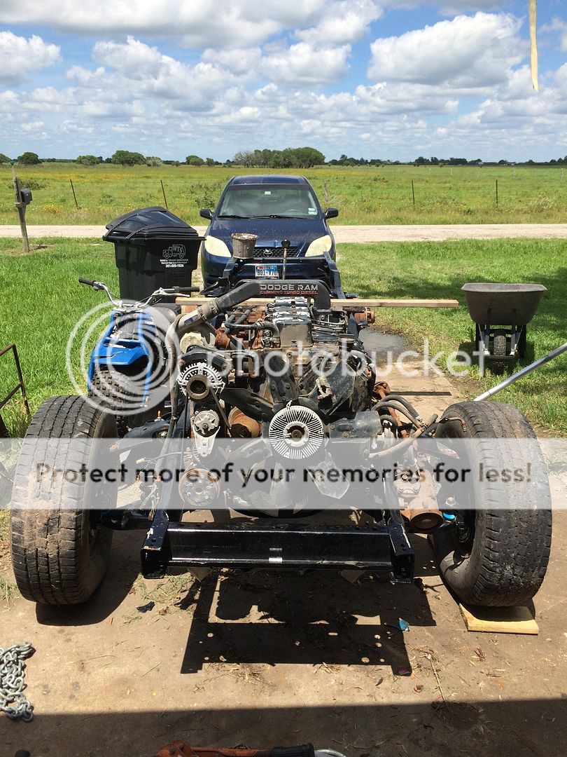

Postby Ghostman » Mon Jun 01, 2015 7:15 am
Well, got the front suspension all done and brakes on and sitting on the front tires.
Then I set the engine and transmission down in it. Getting the transmission crossmember sand blasted along with the leaf springs today.
Next step is to get transmission bolted up and rear axle buttoned up and sitting down on it and then I will set cab back down on it.
I STILL NEED THOSE FRONT RODS THAT GO FROM FRONT CROSSMEMBER TO LOWER A-ARM IF ANYONE HAS ANY PLEASE!!??
