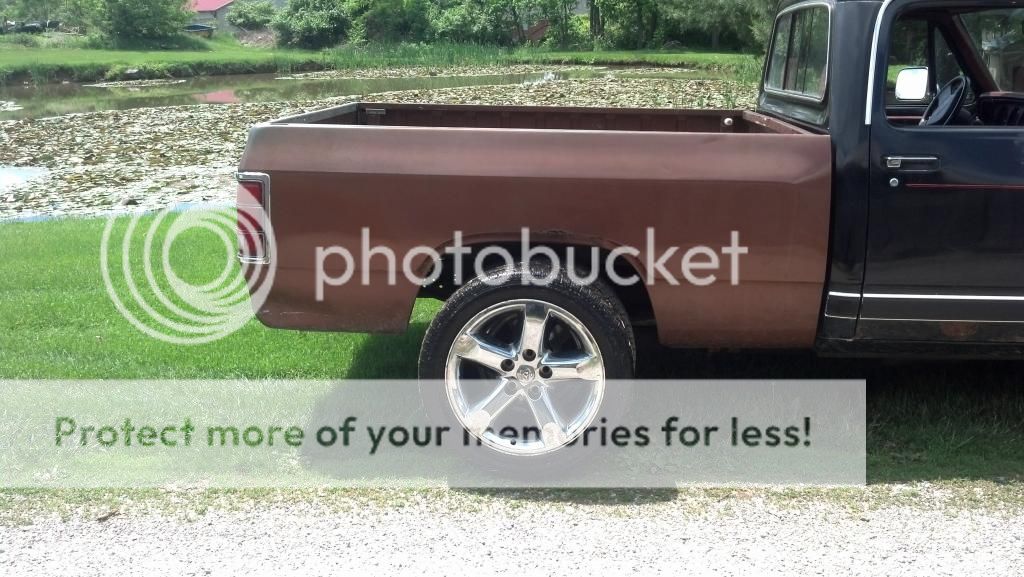

Postby dazedandconfused » Sun May 18, 2014 9:46 am
Well still dicking with the tank setup but I picked up a set of third gen 1500 wheels yesterday from a friend. To you guys running third gen 2500 wheels what size spacers are you running, 1.5"?

Postby cmann250 » Sun May 18, 2014 10:10 am
That looks really good Andy.

Postby dazedandconfused » Sun May 18, 2014 10:20 am
I think they will do nicely on it. I priced some 275/45R20's for $145 a piece today. I'm going to rebuild the frontend and then throw on the wheels and tires. Hope to have it all done by SOP but who knows.

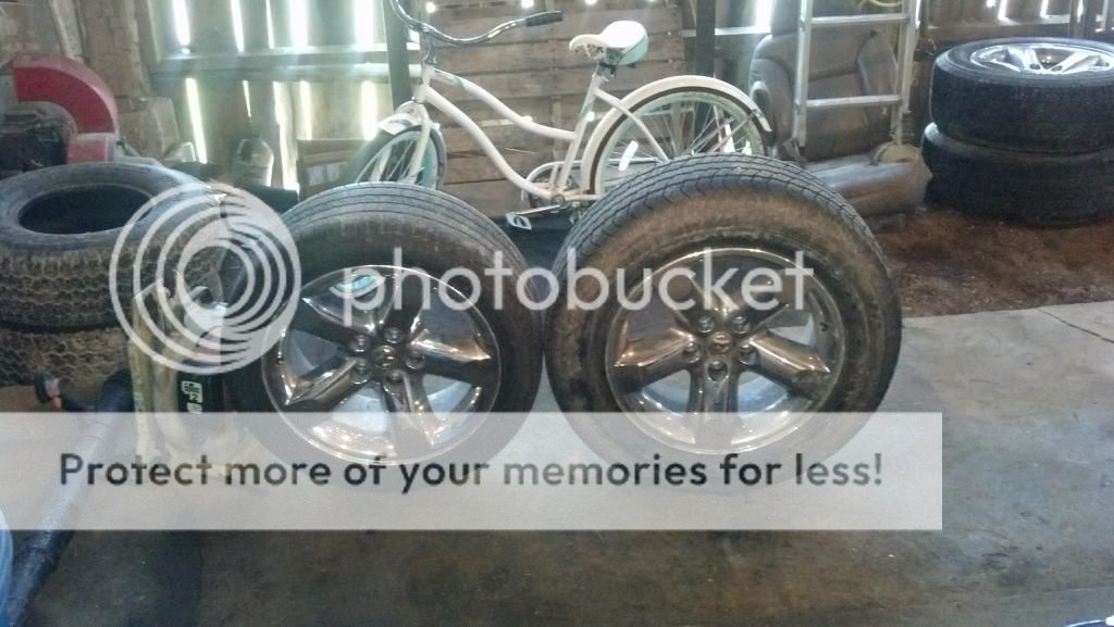

Postby dazedandconfused » Sun May 18, 2014 2:57 pm
Here is a comparison of the shorter 275/45r20 I found in the barn to the 275/60r20 that came on the wheels.

Postby CumminsPower59 » Sun May 18, 2014 6:11 pm
Andy, I'm running 1.5" spacers....but when I do some reconfiguring in the future, I'll go with 2" units.

Postby dazedandconfused » Sun May 18, 2014 6:27 pm
Well after talking to a few guys on Fb that tan these they say you don't need spacers just have to open the centers.
