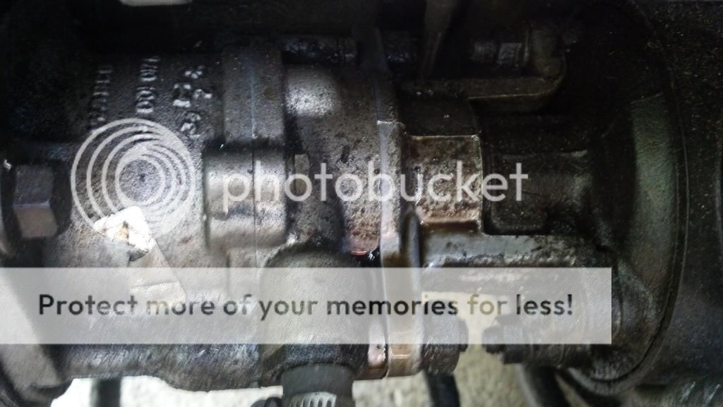

Okay has anyone resealed the vaccum pump and PS pump? I'm leaking oil there and it really needs attention.
Re: Project ugly duckling
Postby RumbleFish » Sat Jun 21, 2014 8:34 pm
Vac pump is super easy. Theres a how to on dtr. Its just a few orings and making sure you get the tang lined up right.
Postby dazedandconfused » Sat Jun 21, 2014 8:36 pm
Any special tricks I need to know to get it apart? I'll have to try and search DTR if I can still get on there.
Postby dazedandconfused » Sun Jun 22, 2014 5:25 am
I found it, thanks for the heads up Jeff.
