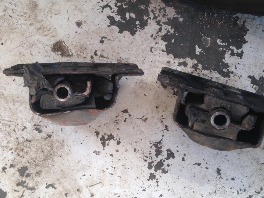

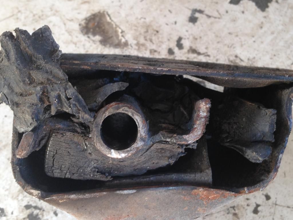

Getting the engine mounts changed out
I mashed the fire out of it
Lots o difference in between the two :lol:
The side effect of this is now my trans is hanging lower :( and throwing the angle of my drive shaft even farther out of whack. Fixing to deal with that now.

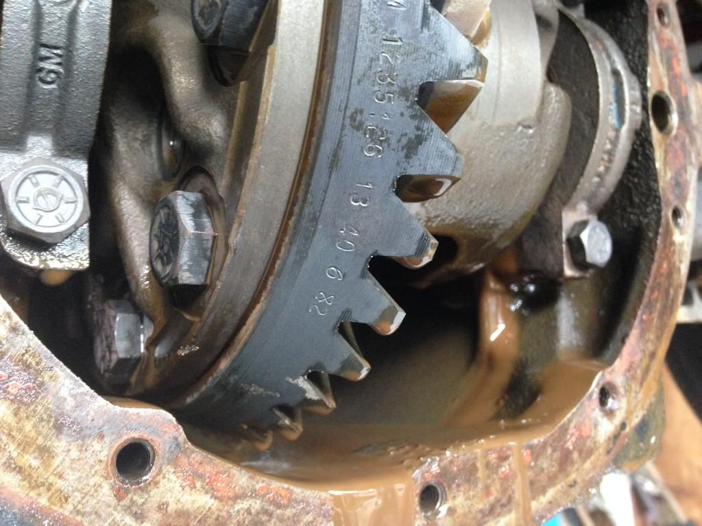

It is a 3:08 rear gear with that weirdo gm limited slip.
Also till I can build a new cross member I had to do this
Not my best work :lol:
Re: Cummins/82 C10
Postby PToombs » Tue May 06, 2014 5:07 pm
Changing the mud in the diff? :lol: Being a mechanic and all I would have thought you checked that before you started driving it? ;)

Pete I'll have you know I did change that grease.....two years ago :lol:
I guess condensation got in there,it never has moved since doing the service.

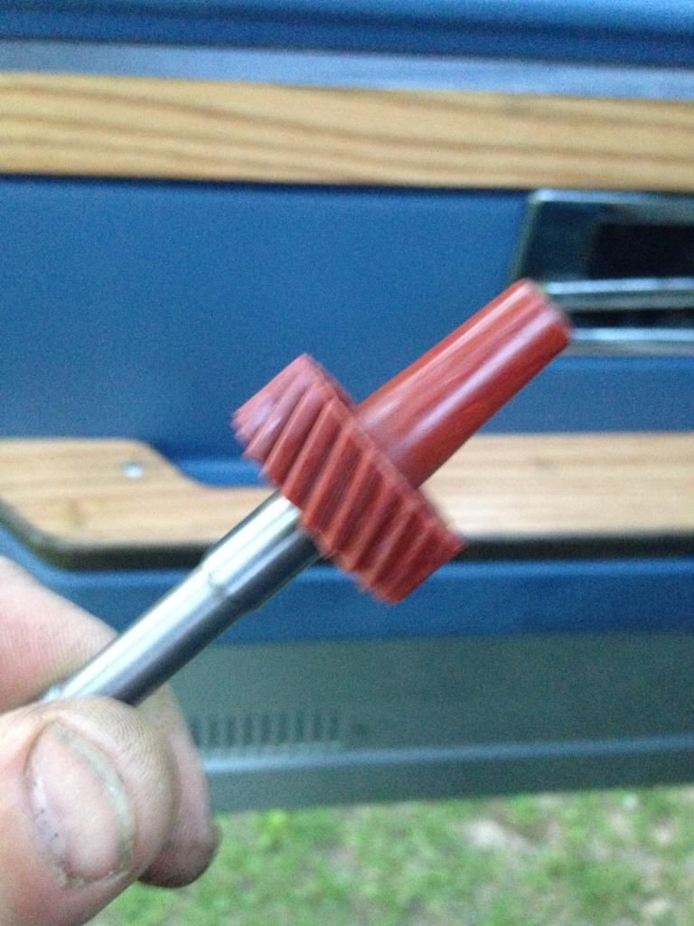

Another piece of the puzzle that is my truck. A 26 tooth gear to correct my speeder meter :)
Re: Cummins/82 C10
Postby ellis93 » Thu May 08, 2014 11:05 am
Well! Should've bought the 29 tooth for 3:08's,the 26 is like 5 mph faster than your running. Luckily I had a reduction gear saved from the gas set up out of this truck,it has the speeder meter dead nuts on. :)

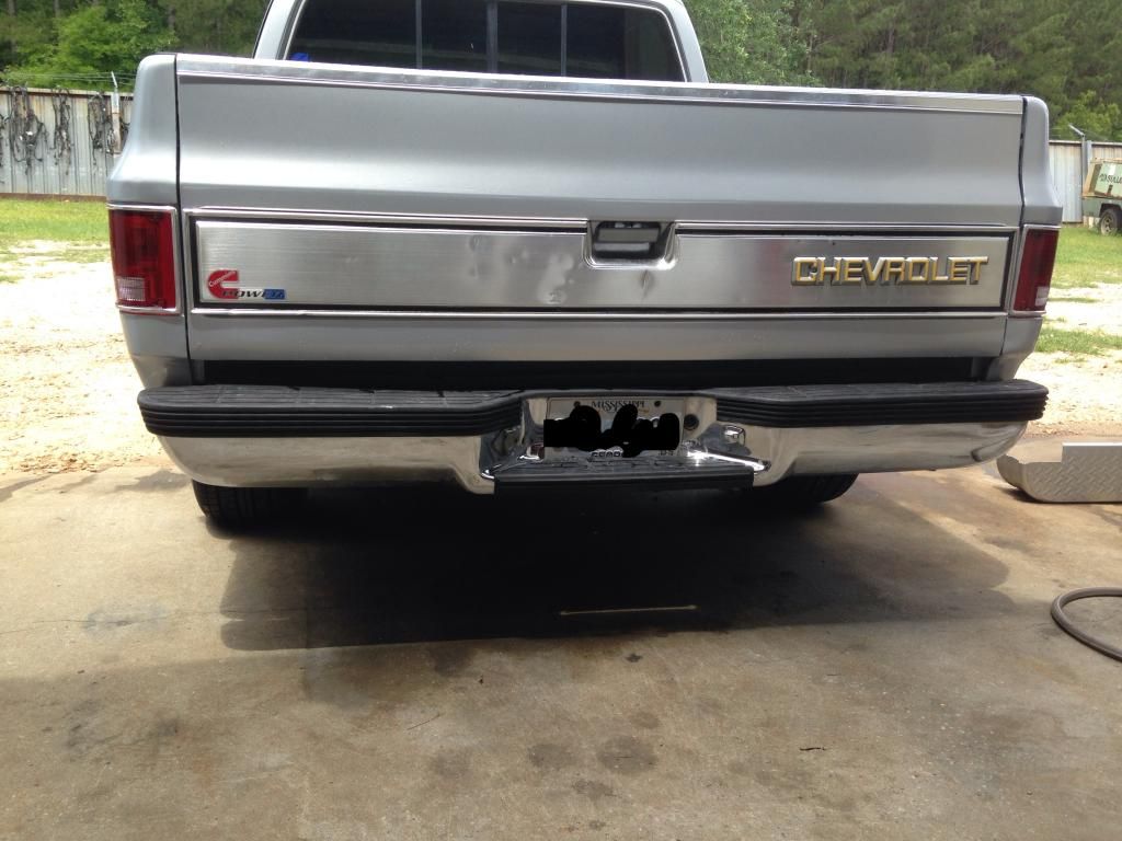

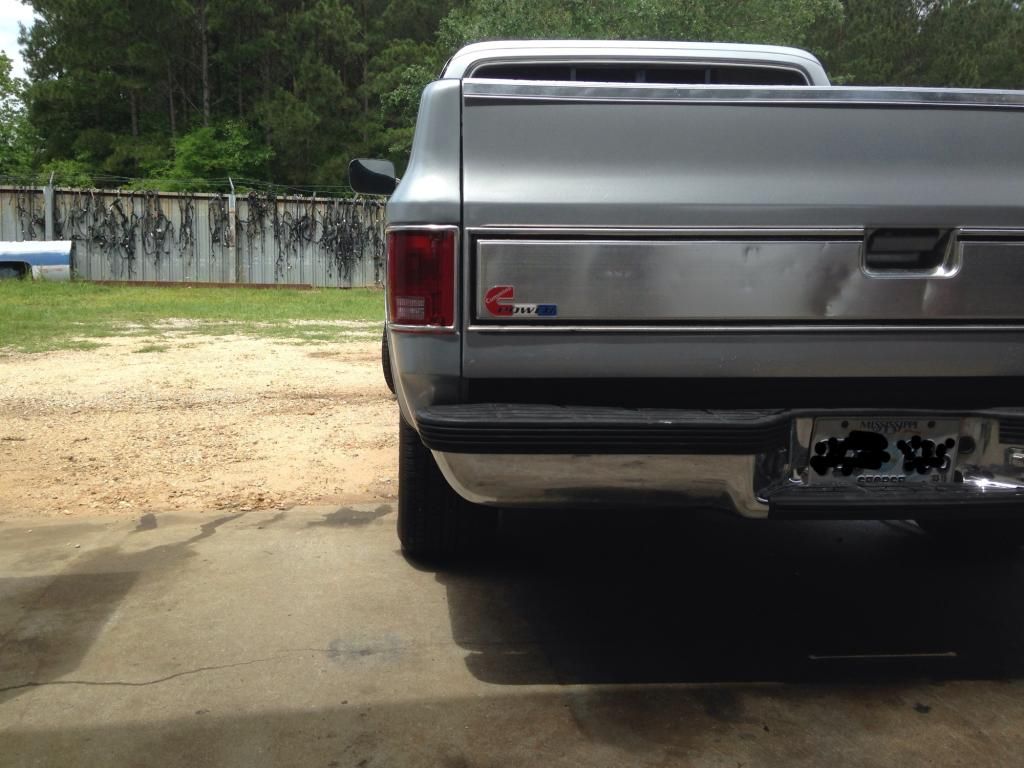

Postby ellis93 » Mon May 12, 2014 10:07 am
Got a rear bumper installed finally,threw on some junk I had laying around. Really just wanted to see what it looked like.
It follows the contour of the bed pretty good
Wish I could find a drop step :(

Postby cmann250 » Mon May 12, 2014 2:45 pm
I bought the 8" drop on mine for $40 at an auction. Beats the hell out of the ones I see on Craigslist for $150 that have rust holes and peeling chrome.

Postby PToombs » Mon May 12, 2014 5:40 pm
Are you that short or fat or lazy that you can't climb up on that low truck? :lol: I think it looks good on there. Now you need to take some brake cleaner and clean the paint off the tag before the cops get you. You shoulda put some cardboard over it. ;)
