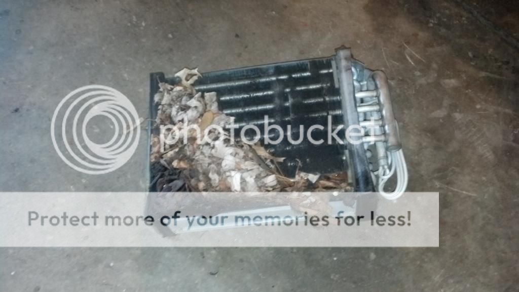

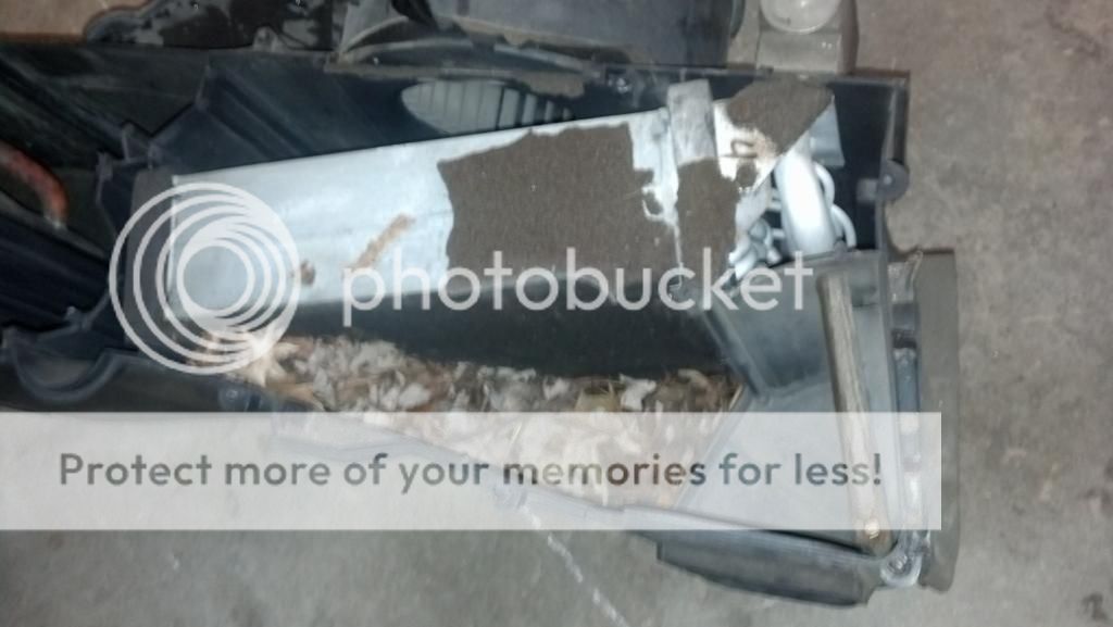

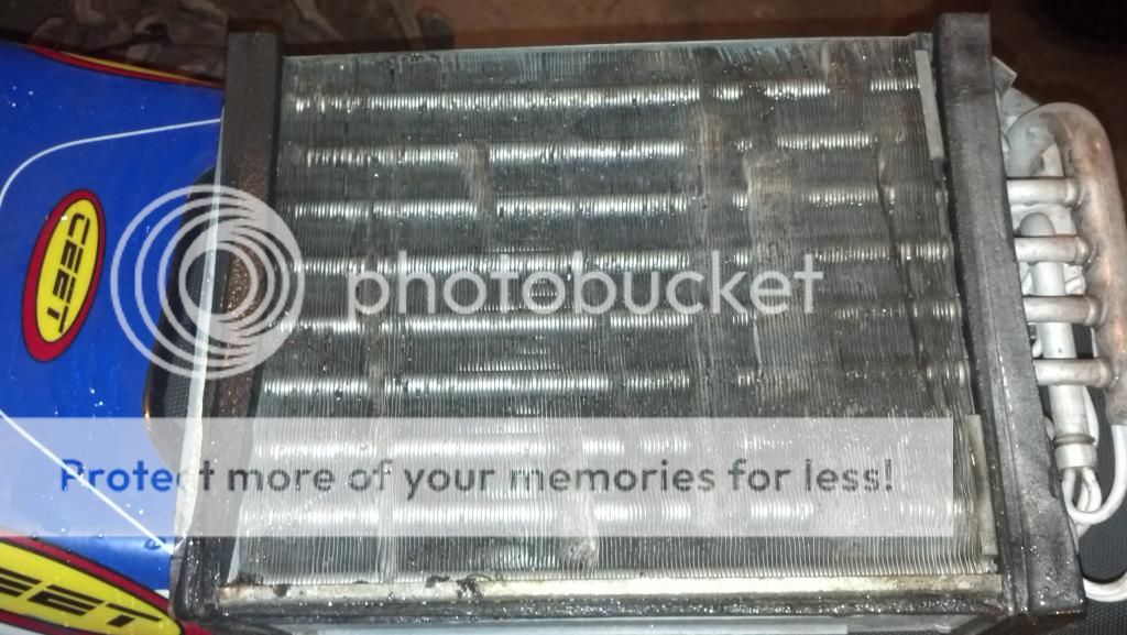

Postby dazedandconfused » Thu Jul 10, 2014 7:11 pm
Pulled the heater box tonight to clean it out. It was half full of leaves but didn't look like it had rotted the evaporator core yet.

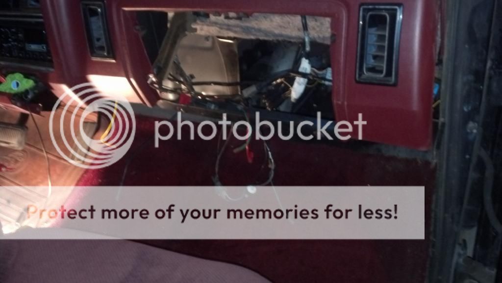

Postby dazedandconfused » Fri Jul 11, 2014 4:40 am
It took me 20 minutes to pull it out. Its actually rather easy. I dropped the steering column, pulled two lower dash bolts and two mid braces bolts. Dash pulled out and box slid right out

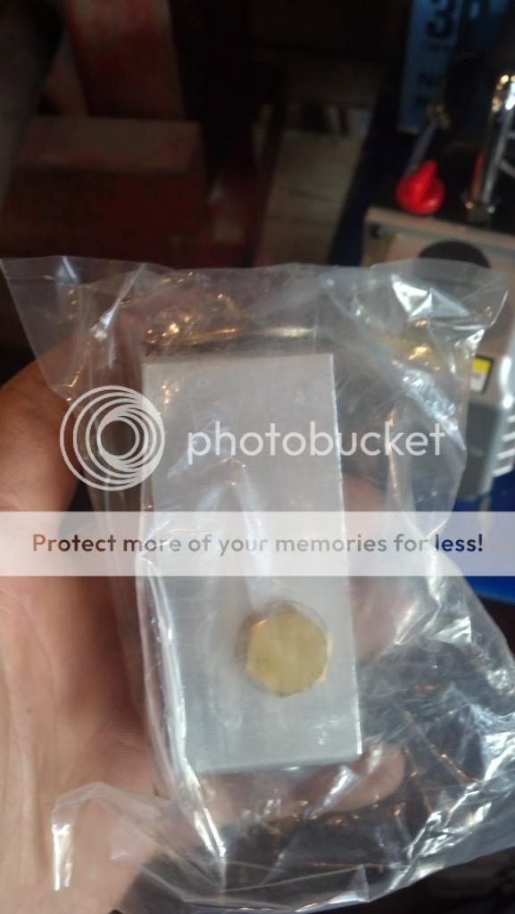

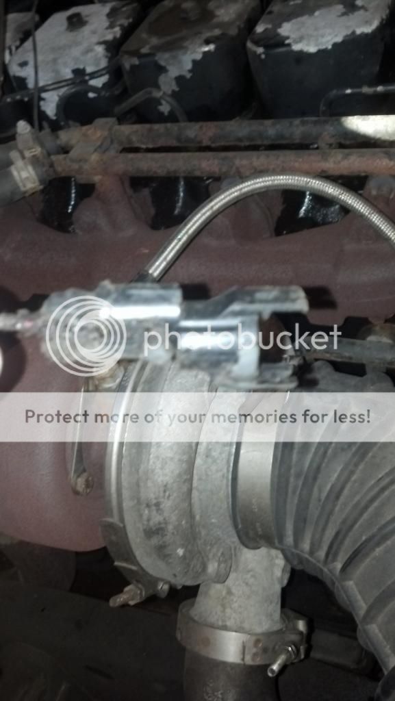

Okay is there suppose to be a switch on the expansion valve? Its been so long since I took out apart I don't remember. The 89 expansion valve has nothing and new 93 has a plug in the side where it looks like a switch will go. Also what is this plug for?
Re: Project ugly duckling
Postby ellis93 » Fri Jul 11, 2014 7:18 am
Yep there's a switch that goes there,only the aftermarket exp valve orientation is ass backwards from the factory unit. That switch will be pointed toward the engine upon installation of the exp valve. You'll have to bend the spade terminals on the switch in order to hook your wires back to it.
If the dodge was close to me I'd snap a pic to show you what I did.
I'd find that switch,you'll need it.
Postby dazedandconfused » Fri Jul 11, 2014 7:21 am
Jeff helped me find the part number I needed this morning. Auto zone had no idea what I was talking about. Any idea what that other plug is?

Postby PToombs » Fri Jul 11, 2014 5:24 pm
Andy, in your 1st pic of the heater box? Slide a piece of screen in that slot just before where the trash is, where the door swings by. I did that to mine and it keeps crap out of there. I wish I had put one on the other side to keep the stuff from going thru the fan.
Postby dazedandconfused » Fri Jul 11, 2014 5:33 pm
PToombs wrote:Andy, in your 1st pic of the heater box? Slide a piece of screen in that slot just before where the trash is, where the door swings by. I did that to mine and it keeps crap out of there. I wish I had put one on the other side to keep the stuff from going thru the fan.
To late for that its already back in the truck after a good cleaning. My last two parts should be here tomorrow.

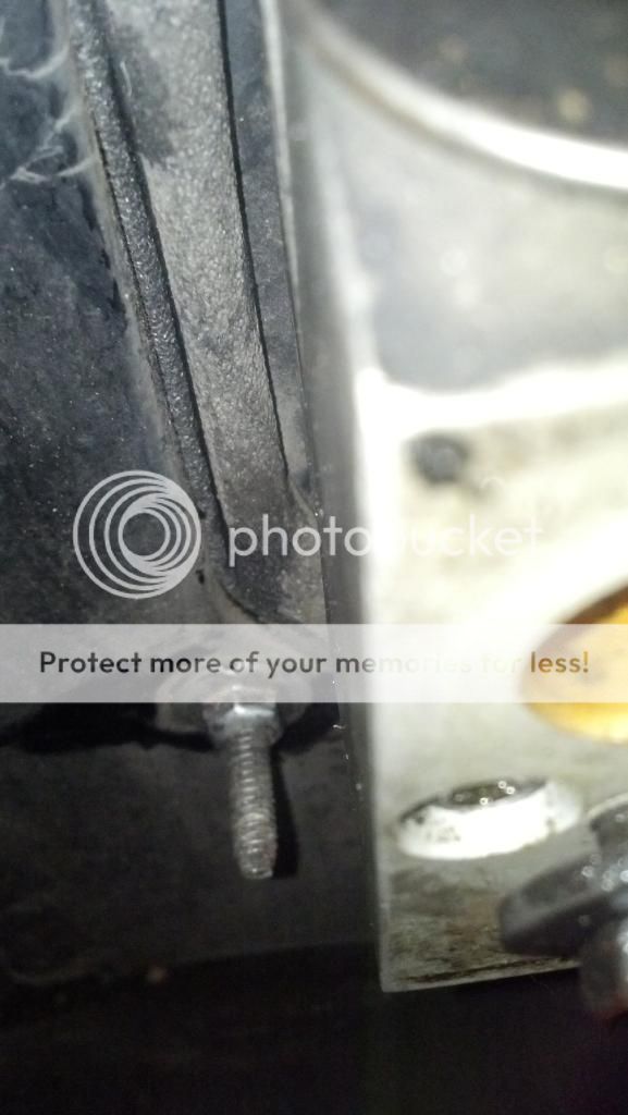

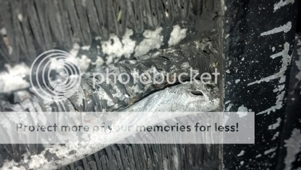

Postby dazedandconfused » Sat Jul 12, 2014 5:23 pm
Well I was putting everything together today and found this.
