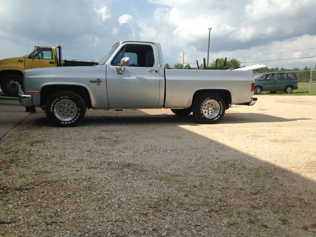

Well today I replaced every piece of the brake system except the lines and hoses ,the hoses looked to have been changed in the last ten years,so I left them :lol:
It's stopping much better but the whole reason I did it was because I had a caliper dragging on a warped rotor,I "thought" that was my high speed shake I've had..... I though wrong apparently. It's still there :roll:
Also decided to use it to move some tools to a new side job (trim work)
Those back springs are some kind of weak :lol:
Looks like either air bag or air shock time ,can't have a truck I can't use as a truck ;)
