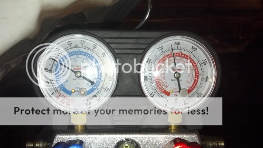

Well thanks to Chris I got a condenser today. Pulled vacuum for an hour at 30. Left it sit for 20 minutes it dropped to 25 and stayed there for an hour and a half. Filled the system with 6 ounces of pag 100 oil with dye then 2 pounds of R134A. Its not working as it should and I can't figure it out.

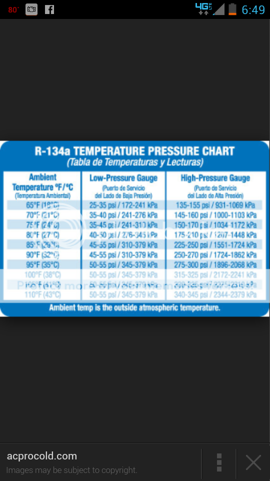

This is the chart I was going by. Its 80 outside when I charged it. This was after I had to hotwire the compressor to make it work. New expansion valve, sensor in valve, drier and flushed entire system. Any ideas?

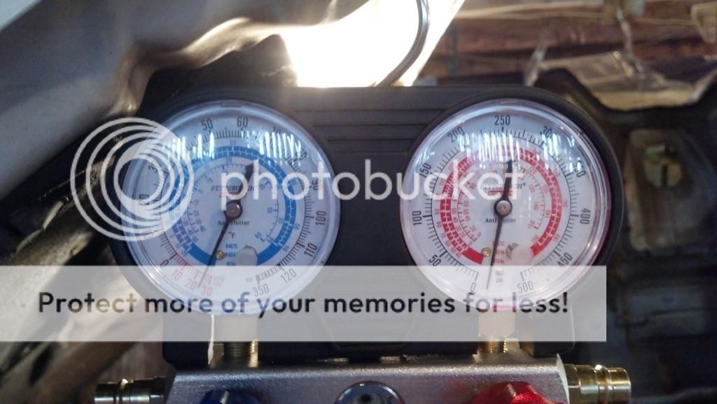

Just got home and checked it again. Its 75 outside and the truck was cooling down to 59. Here is the pressure.

Postby oldestof11 » Sun Jul 13, 2014 7:15 pm
Im assuming on MAX AC and fan on HI right?
Is the compressor kicking on and off or just staying on?
Re: Project ugly duckling
Postby ellis93 » Sun Jul 13, 2014 7:42 pm
My money is on a pos exp valve, aftermarket are horrible.
Have you drivin it running the system yet?
Wet the condenser when idling and see if the air gets colder, and watch the pressures.

Postby dazedandconfused » Mon Jul 14, 2014 2:50 am
Max ac with the fan on high. The compressor won't come on unless I hot wire it. I drove it home and that last picture was of the pressures after getting home. What controls power through the ac system?

Postby dazedandconfused » Mon Jul 14, 2014 12:17 pm
Ran it all the way home but wouldn't cool below 70. Pulled in drive and checked pressures again. Low side was 32 and high side was 235. So is there anything you can do to the expansion valve to try and help pressures? Any other vehicle that shares the same expansion valve I could find in the junkyard?
