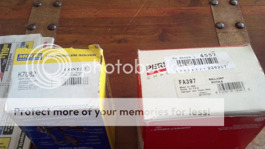

Okay just thought I would share this. It appears all upper control arms from atleast 1983-1993 D150-D350 are the same.
Re: Project ugly duckling
Postby oldestof11 » Mon Aug 04, 2014 3:12 pm
Whats the difference in the height?
Postby dazedandconfused » Mon Aug 04, 2014 6:01 pm
They are almost identical in height. This shows that they used the same upper control arms for all D models. Ball joint shank are smaller for the lighter axle though.
Postby oldestof11 » Mon Aug 04, 2014 6:14 pm
Gotcha. Thanks!
Postby dazedandconfused » Mon Aug 04, 2014 6:35 pm
Waiting on a size for the D150 lower ball joint.
