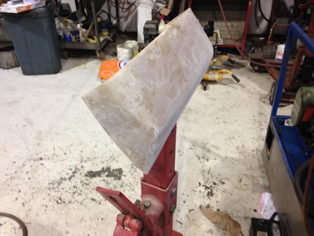

Made some progress on the dash pod
That's the basic shape I'm after,I just smeared a little bondo on it to smooth it out. Tomorrow I sand and see what's up :lol:

Postby PToombs » Wed Oct 01, 2014 6:11 pm
Be careful! If you make it too nice that could turn into a full time job! :lol:
