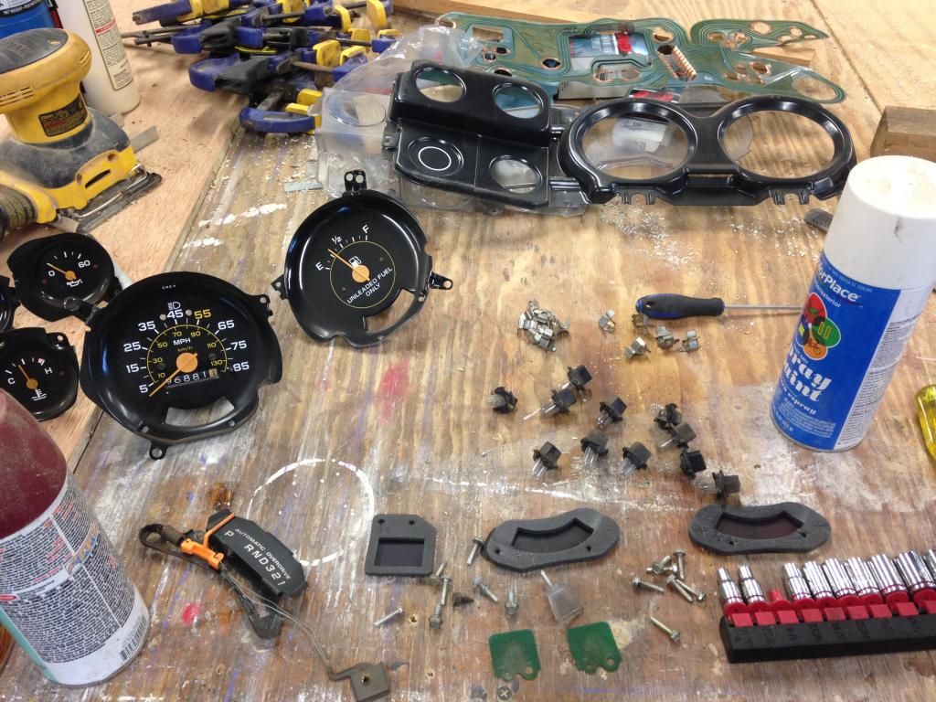

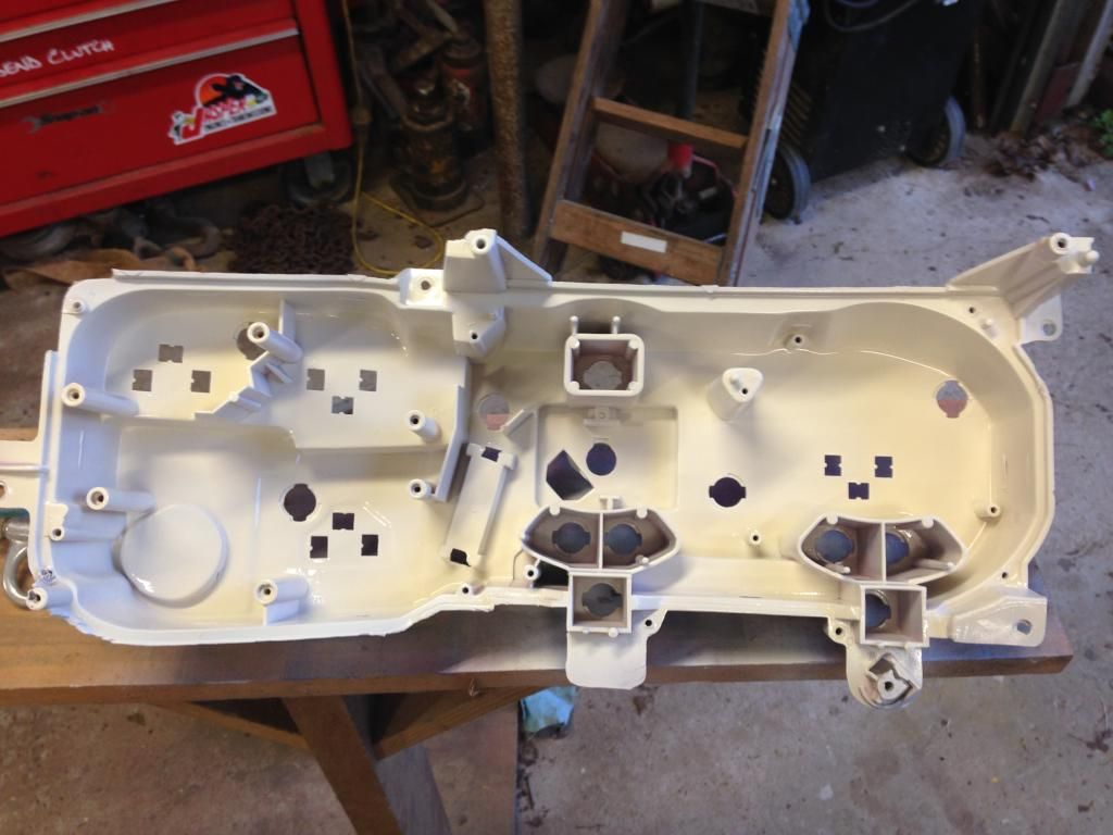

Anywho.....I'll be pimping it this week to reproduce the issue so I desided to go a little farther than I wanted originally.
I have ran these trucks for years and have never had decent dash lights. Due to a Facebook post in one of the 73 to87 chevy groups,I felt like I should give this a try. Basically you take some of that plastic adhesion paint and paint the back of the instrument cluster so the lights has a better reflective surface.
Original color
Painted
And this is the crap I had to remove
I've kind of taken a big risk fooling around with a 32yr old printed circuit :lol:

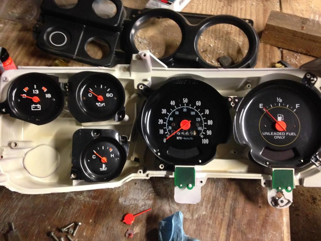

Postby ellis93 » Mon Oct 13, 2014 5:56 pm
Dug around my chevy parts and found a cluster from an older model with a 100mph speeder meter in it to replace the 85mph unit. Painted the needles and the color blocks on the other gauges. Reassembled most of it and need to polish the clear cover. It's really scratched up and I can't stand the cloudy look either.

Postby ellis93 » Tue Oct 14, 2014 7:07 pm
Dashboard is back in! What a humongous pita too! Between all the wire and the copper tubing,snaking that crap thru the dash was tedious. Had to move the dash pad a little at a time and pull the slack at the same time...under the dash. I almost didn't have enough arm for that :lol:
The cluster painting thing worked like a champ,it's at least twice as bright even with the plain Jane bulbs in it. (O'Reilly wanted 20$ for a two pack of LEDs :shock: )
