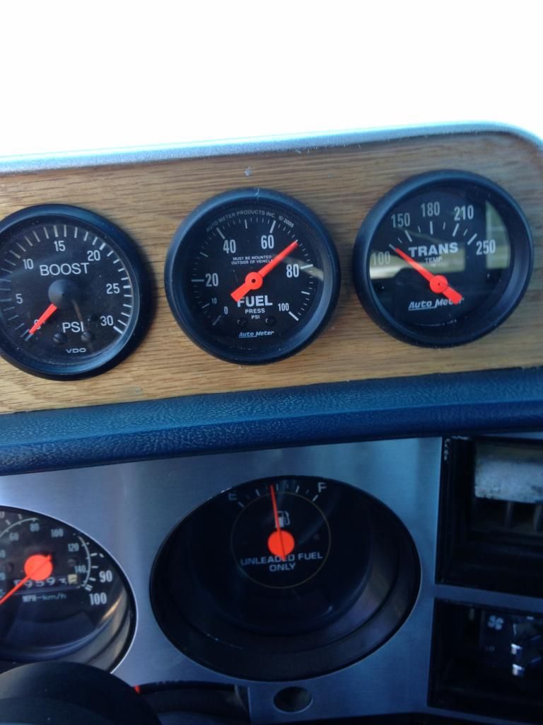

And I fooled with the fuel pressure too. Like bigblue did in his tread I used a bic click pen spring and got this

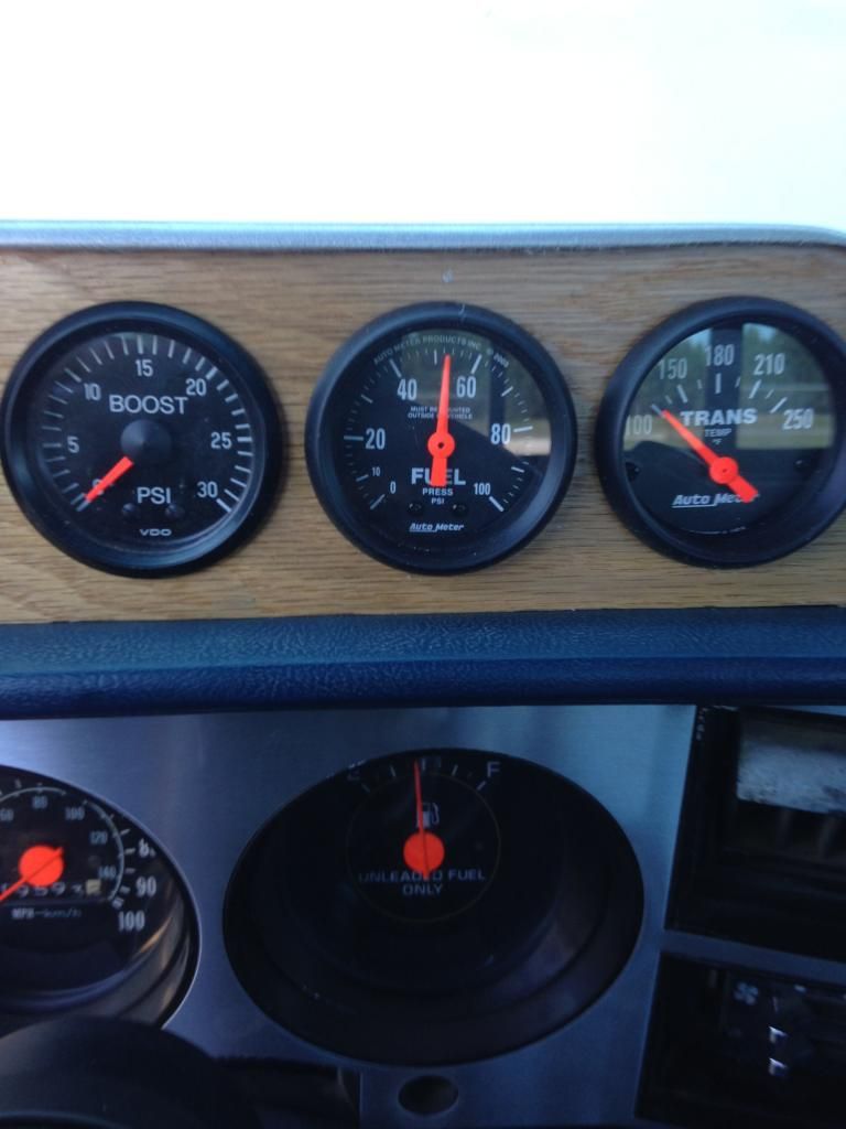

I immediately pulled that spring and trimmed it by three coils,tightened the end coil again and got this.
I couldn't in good conscience leave it at 70. There was zero fuel return to the tank,plus with the line I have running to the filter feeling rock hard it was worrisome.

Well no dice on the pressure thing,I have 10lbs of fuel pressure now. Freakin stupid spring :roll:

Turns out the diameter of the spring matters. That's something that wasn't mentioned in the post I read,nor did I take the valve completely out to see the entirety of its inner workings.
I thought it was just ball,spring,shim then bolt. Wrong answer camel head.....it's ball,spring SEAT,spring,then shim and bolt.
There is a nub on the seat that the spring rest on,that nub keeps it centered as well.
I just removed and reinstalled the overflow valve and found that seat cocked in the hole holding off the spring,and dumping pressure.
I'm seeing 60lbs right now so time will tell if I've done anything here.
