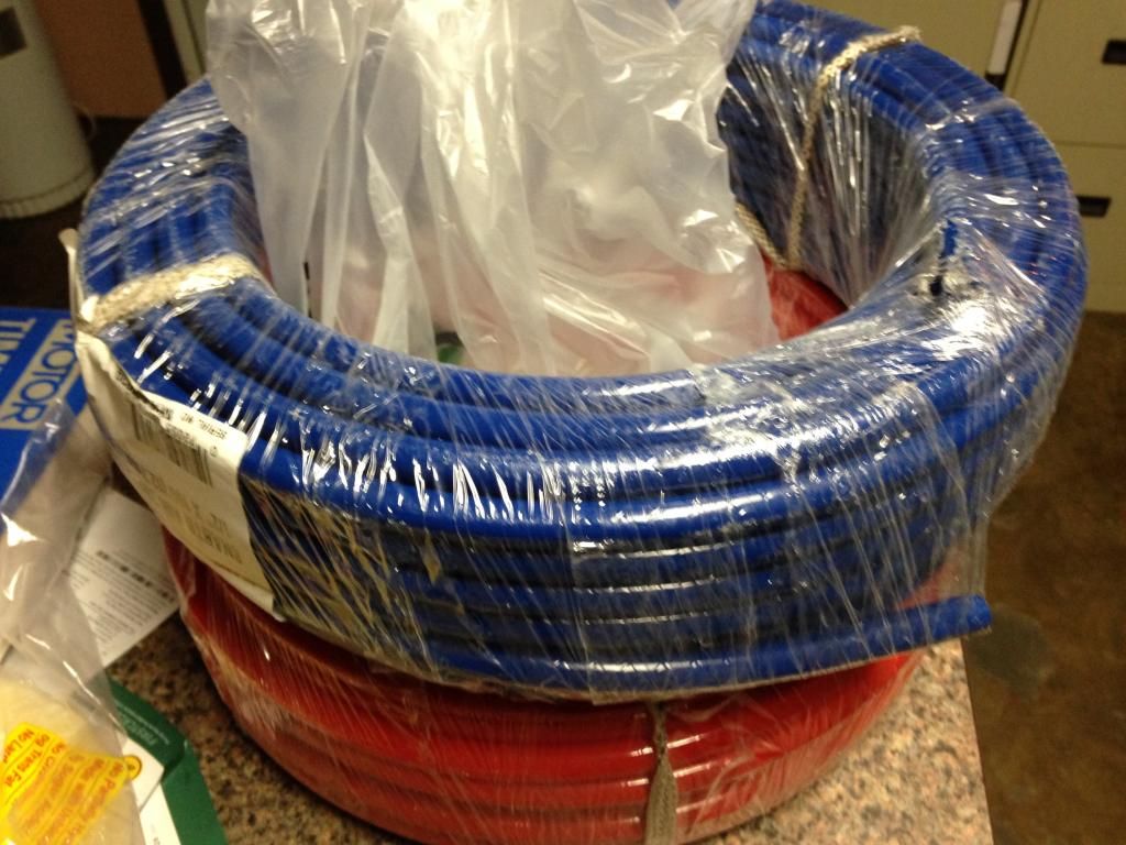

Postby ellis93 » Tue Nov 25, 2014 5:15 pm
Well I'm buying up new supply lines for the chevy and the dodge.
And an assortment of 1/2 compression fittings and the stainless air brake line inserts.
It's not the cheapest way to go for line but seeing the rubber line I have,connecting the metal lines,swell up I figure this won't be. :D

Postby PToombs » Tue Nov 25, 2014 5:44 pm
1/2 inch tube is only 3/8 inside you know. I found that out when I did my truck. I went with 5/8, that's about 1/2 inch inside. Stuff works great though, I love it! 8)
Re: Cummins/82 C10
Postby ellis93 » Tue Nov 25, 2014 5:49 pm
I know,I don't figure on needing any bigger tho. I'll be running the largest electric pump I can find as a pusher and at crazy pressures. It should supply enough fuel to let the engine get enough fuel to twist the wimpy frame of the truck in half. Time will tell I guess :?
