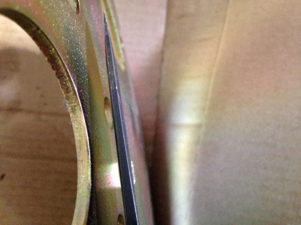

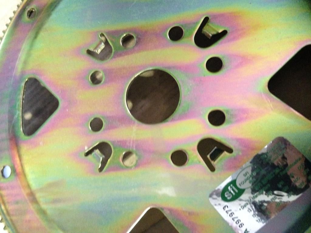

I got the flywheel in today. Pretty beefy piece,way thicker than what I remember hanging off the engine now.
Next to the kershaw knife blade.
I guess I'm gonna pull the trans and buckle up this flexplate,then run it till I make up my mind on converter. I emailed the DPC folks and liked the reply I recieved so I'll probably just go with them. I just need to decide to drop the coin or back up totally and punt the whole truck. I'll be super pissed off it I drop 500+$ on fooling with converters and it still be slapping/knocking/ticking.

Postby cmann250 » Mon Mar 02, 2015 2:46 pm
That's not the one I had. You may want to watch bellhousing spacing in there. I think fatty and BC have that one.

Postby fatty » Mon Mar 02, 2015 8:04 pm
No I have one from PRW. It did require a spacer on the bell housing.
