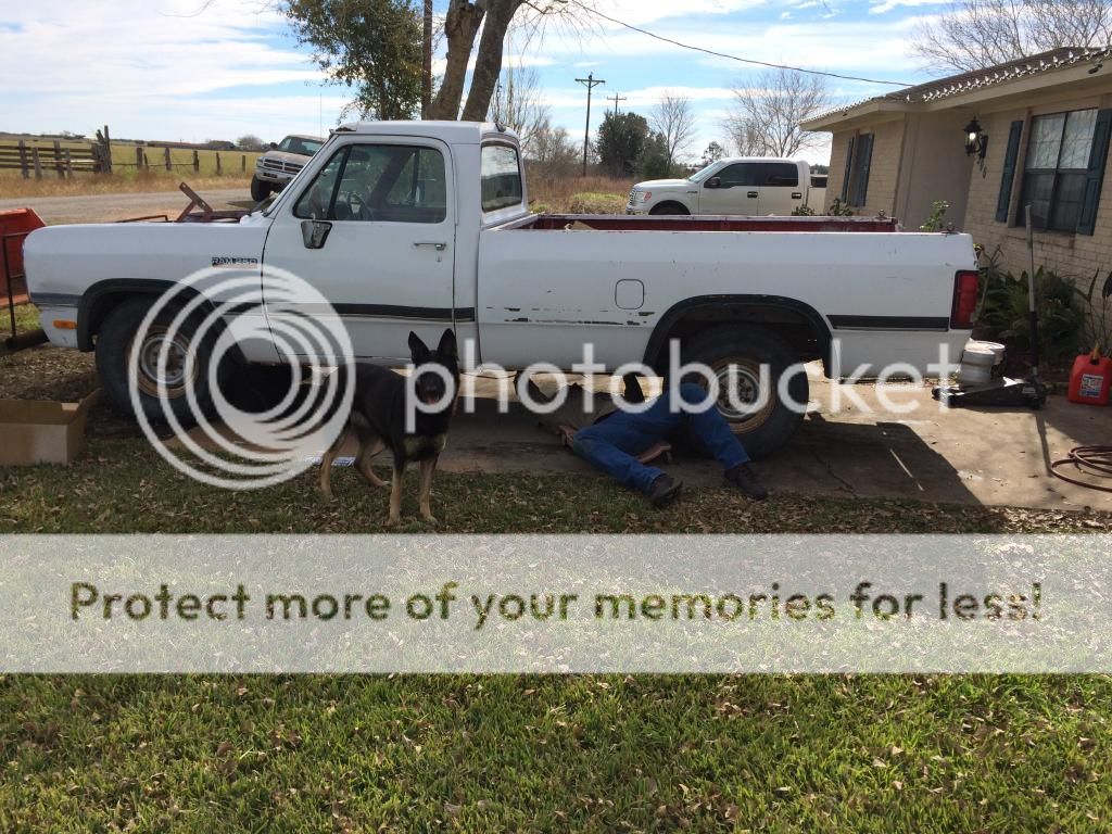

Postby Ghostman » Wed Jan 21, 2015 2:09 pm
Pretty much been a beat up farm truck with lots of Aggie Engineering done to it lol. :roll:
Hood off and you can see how bad the rust on the roof is. Found a donor cab in much better shape.
Taking the bed off. Going to end up building him a nice flat bed with some wooden touches to make it seem more old timey.
My Dad giving me a hand pulling the fenders off.
Here a picture of both cabs. I'm going to strip them both down and haul them in to a body shop for a complete makeover. Along with the other panels. They want it two-tone, Aggie Maroon and white.

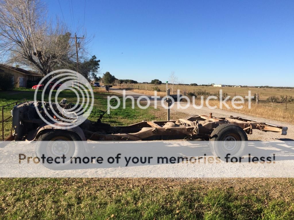

And here's where I'm at so far. Going to completely get frame stripped down and haul it in for blast and paint.

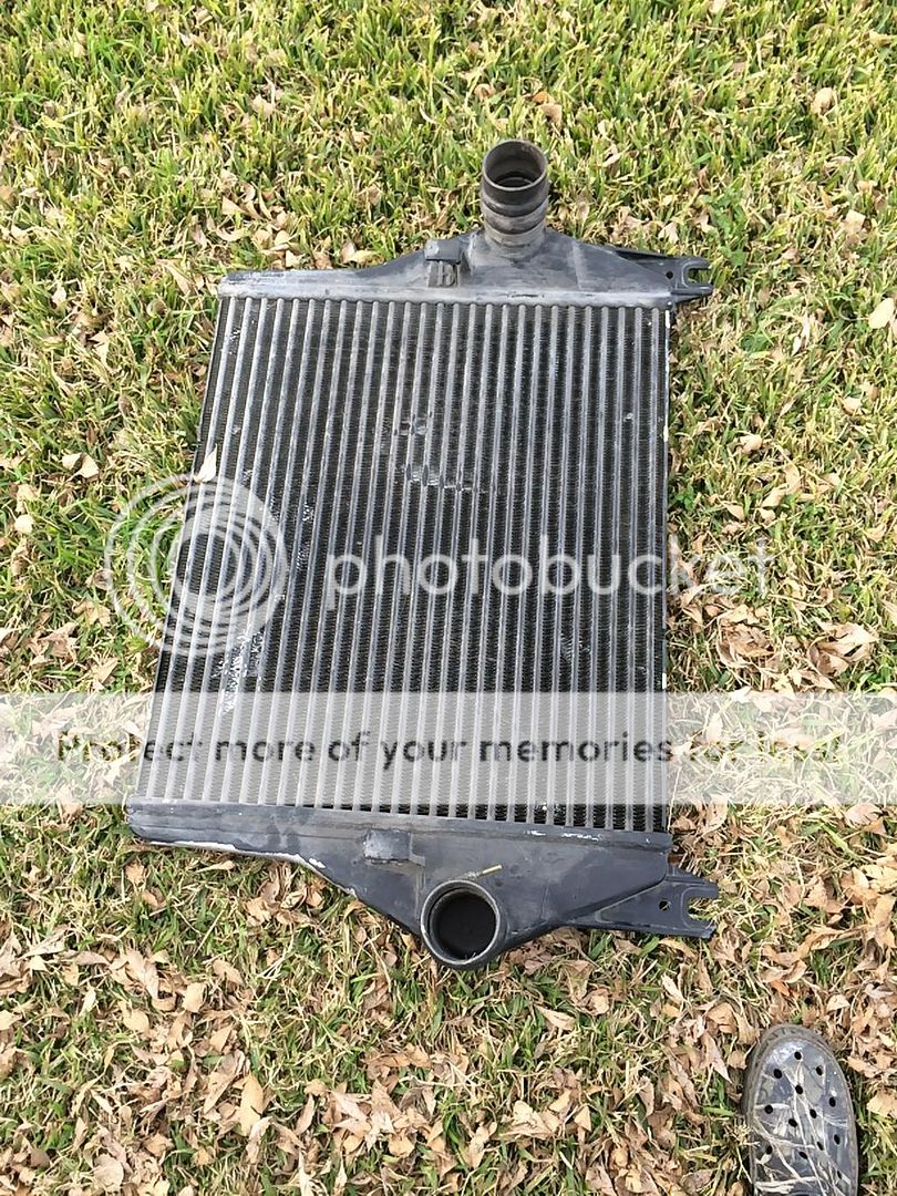

Picking up a stock 3rd gen intercooler tomorrow and going to shorten it to fit.

Postby Ghostman » Sun Jan 25, 2015 5:21 pm
Got te intercooler for $100 and 3.75 hr round trip. Looks pretty good. It will have to be shortened but I think it will end up fitting pretty good once im done.

Postby DMan1198 » Sun Jan 25, 2015 5:55 pm
How would you shorten it without compromising its ability to hold pressure?
Re: 1991 RCLB Restoration
Postby PToombs » Sun Jan 25, 2015 6:05 pm
Ducati, it's easy. Just cut off the section you see sticking past the radiator in the last pic. You cut the tanks, remove that section with the cores and then weld a plate on each tank to seal the hole. ;)
Postby Ghostman » Sun Jan 25, 2015 6:34 pm
Exactly what PToombs said pretty much. I saved some rubber feet off some old radiators too.
