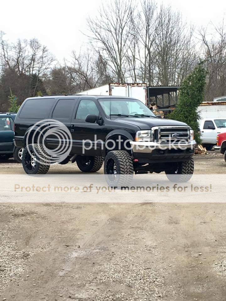

Postby 12Vexcursion » Mon Apr 04, 2016 11:08 am
Sorry to disappoint. Truck has been done for almost a month now. Put 3k miles on it so far
Will seriously try to post pics I just don't have a desktop so photobucket hates me on my iPad

Postby dazedandconfused » Tue Apr 05, 2016 11:54 am
Here are a few Matt.
Re: 2000 excursion 94 p pump nv4500
Postby 12Vexcursion » Wed Apr 06, 2016 8:40 pm
Thanks for the pics Andy. I'll get all of me from the build posted soon
