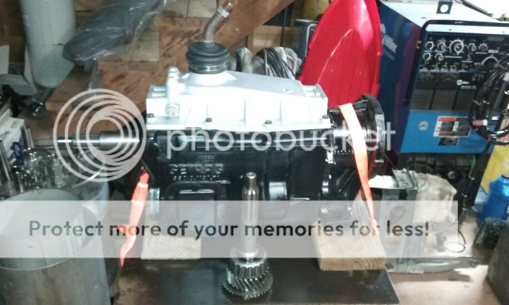

Getrag 360 rebuilt with new input shaft, bearings, synchros
NP205 not rebuilt now, just cleaned up and painted

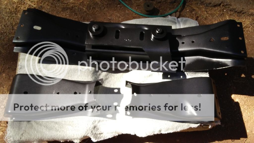

4X4 crossmember installed with grade 8 hardware

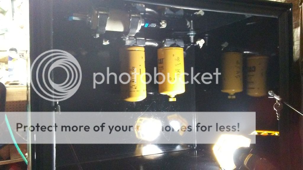

24" Delta underbed boxes, fuel supply system mounted in driver side box

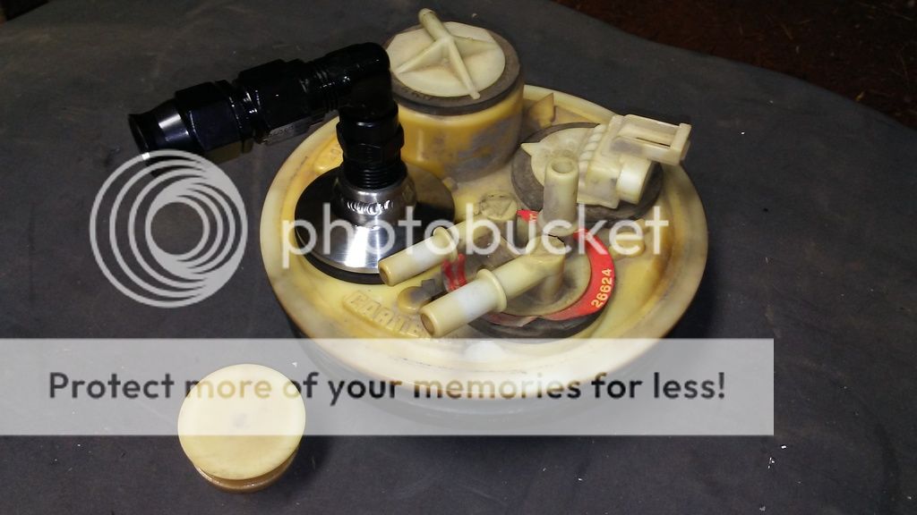

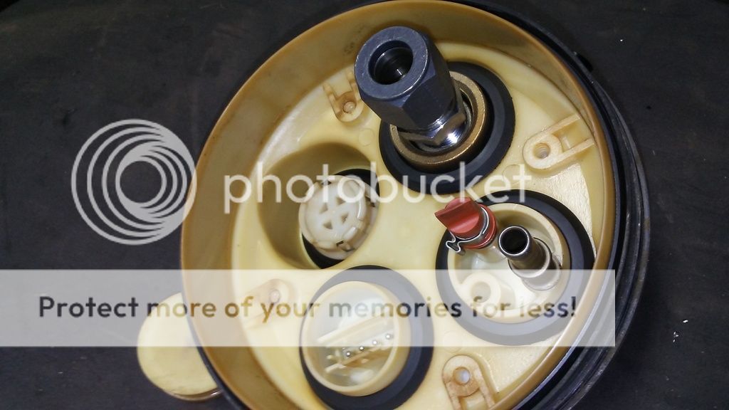

For the fuel system, I ran a new line off the drawstraw for supply, regulator bypass ties into stock supply line, and stock return is unmolested. LP power is run through a 15 amp fuse and then a 22 amp relay triggered by a switch in the cab. My clutch hydraulics have been sitting in my garage for almost the entire five years I've been accumulating these parts so time will tell how it holds up but it works well. Had to install 6" lift blocks in rear for the driveshaft to fit so the truck has some stupid rake now until the SAS is done up front. Still need longer shocks and to reattach airbags to spring packs.

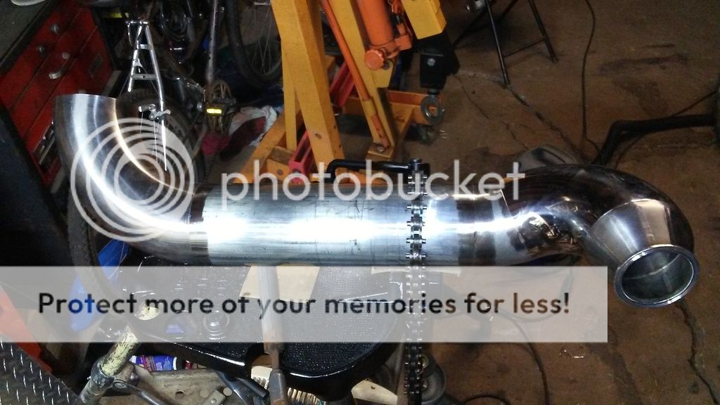

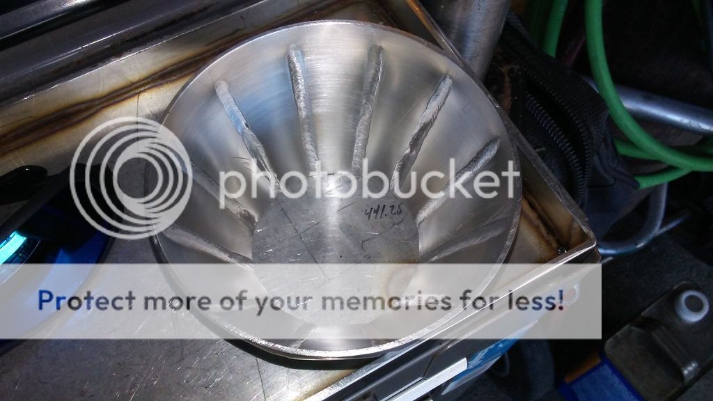

I'm using 4"x.065" wall 304 stainless tubing for my exhaust, I got it free at work. I cheaped out on the v band flange and tried making one from a 2.5" tri-clover cap, almost works but the clamp doesn't quite get tight enough. I'll have to rework that later. For the reducer I took some tube and made an orange peel reducer with 12 fingers. I'm working on the offset around the t-case then I'll run the tubing behind the axle. No plans for a muffler yet, hoping a full length exhaust pipe will be enough. I'll probably have to add a heat shield by the hvac unit too.
orange peel reducer:
downpipe with temporary 90 elbow dump behind pass tire:
in the truck:

What industry are you in if you don't mind me asking? That down pipe looks real good along with the welds.
