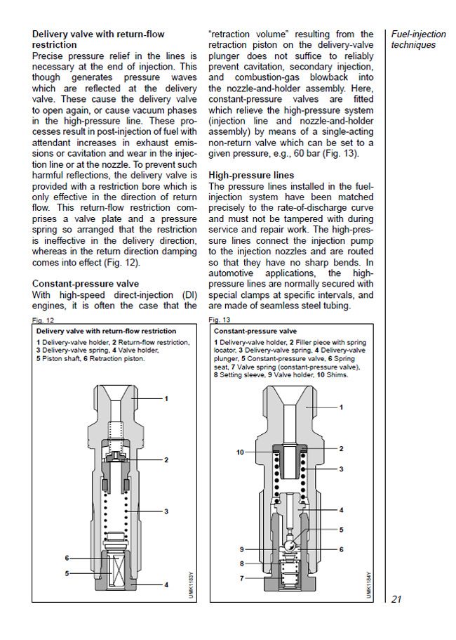

oldestof11 wrote:Going off of this:
Douchem @ CompD wrote:VP44's don't have delivery valves.
http://competitiondiesel.com/forums/sho ... stcount=36
of which our own KTA later confirmed in a thread on here...
and a part in the VE manual about the DV's being for low RPM emissions.
Stupid BUT I want to see what happens. Also drilling out the holder slightly to accommodate an increase in flow at higher rpms. I remember pinning out the holder and injection lines. I remembered thinking just drilling it out slightly.
Fixed your post for you. :roll:
I could have gone another long while before reading that crap again.
Re: Drilling the vane pump?
Postby AHineman » Thu Jan 10, 2013 4:54 pm
I like what ya did there BC. 8) :lol:
Postby BC847 » Thu Jan 10, 2013 5:01 pm
FWIW:
My absolutely preposterous suggestion of air binding the injector is apparently enough of an issue in certain situations that Bosch developed DVs to address such as well as other related issues.
-Read "Constant-Pressure Valve"
. . . . "Combustion gas blowback into the nozzle and holder assembly"
I want some of what they're smoking!!
