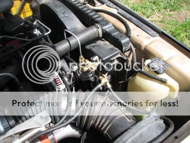

I think I have it dialed in pretty good right now. lights almost right away, makes 45psi. Mods are, ground fuel pin. pump almost maxed,(unknown injectors) procomp lift pump, timing to the head and 4" exaust.
With this turbo I hit 1700* at 85mph in 4th gear. before the turbo and the timing I could hit 2100* in 4th gear. :oops: A few more mod's are in order but I'm getting closer. :D
If you didn't know this is a he351vgt. I'm useing drive presure to open the turbo, a spring to close it and boost to balance it out. I have a filter and a needle valve on the drive presure line.
89 non-I/C W-250, flatbed. 4" turbo back. Ground fuel pin, AFC tuning.

Looks Good but you need a bigger filter

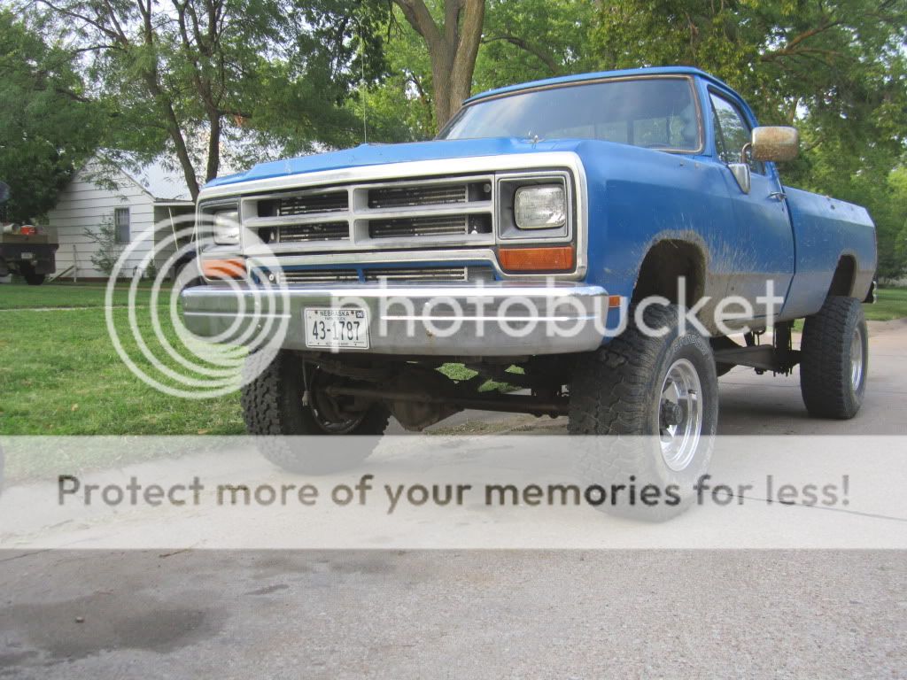

Postby huntinguy » Mon Jan 14, 2013 1:10 pm
Update!

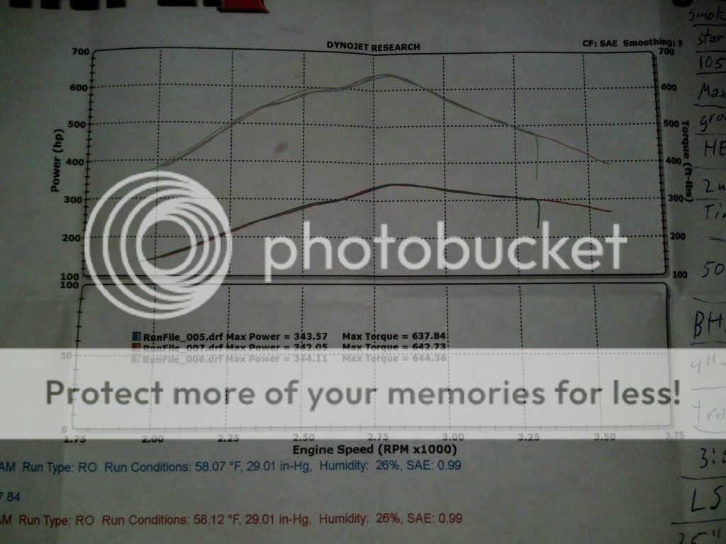

This truck is now intercooled and cranked up a little more. It did 15.853 in the 1/4 mile this summer with 33's and a bad boost leak.
This fall it put down 346hp on 35's with a minor boost leak.
This dyno didn't have a brake and my rear brakes were out so the number is a little low.
Looking a little less ugly these days.

Postby cmann250 » Mon Jan 14, 2013 1:32 pm
Minor subject change... Did you keep your A/C condensor with that intercooler? If so how?
Re: My VGT setup.
Postby dunes450r » Mon Jan 14, 2013 1:41 pm
cmann250 wrote:Minor subject change... Did you keep your A/C condensor with that intercooler? If so how?
similar topic: it appears you used a second gen intercooler? i have the same pickup, and a second gen intercooler. if ya wouldn't mind posting some pics of your install, and maybe what intercooler tubes you used?
thanks!!
dunes450r
Posts: 318
Re: My VGT setup.
Postby huntinguy » Tue Jan 15, 2013 6:41 am
No more AC and my tubes are custom made.
