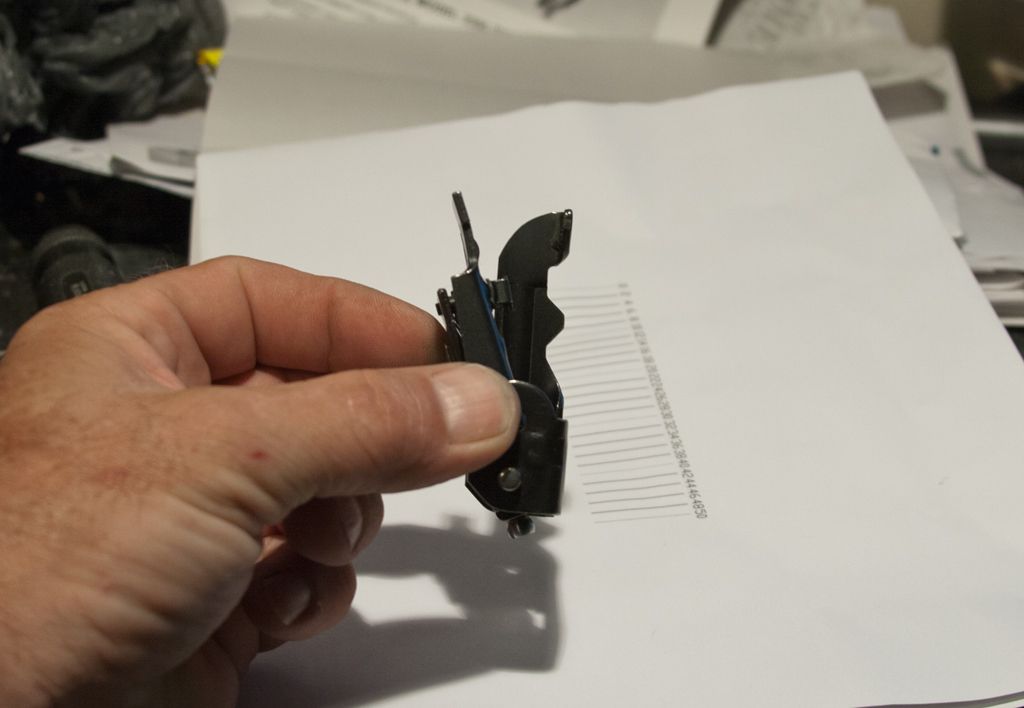

Indexing? I don't have a photo but IIRC, if one were to look at the left half of things, looking down on the throttle-shaft, the lie of the shaft would be at the topmost line on the plate.
Ever played with the throttle cage thingy?
If so, you've possibly noticed the fuel-screws lever has it's own pivot-point (my thumb's got it). At the bottom of that lever, is a second pivot-point that the throttle-lever, and governor-lever ride on. The governor-lever has the actual spill-port collar connection (post).
It seems to me that the fuel-screw lever gets things in the ball-park if you will. The throttle-lever sets the tone (your foot's input) with that being influenced by the governor-lever.
At one point,I apparently had my (modified) fuel-screw in so far it would limit the return position of the throttle-lever. I think this would explain how/why I was able to set my idle . . . by way of my main fuel-screw. :?
Frankly, last night I just played with a couple of different index settings. I actually got it to where it acts like it would runaway if I ran the main fuel-screw in any further. That's a first.
