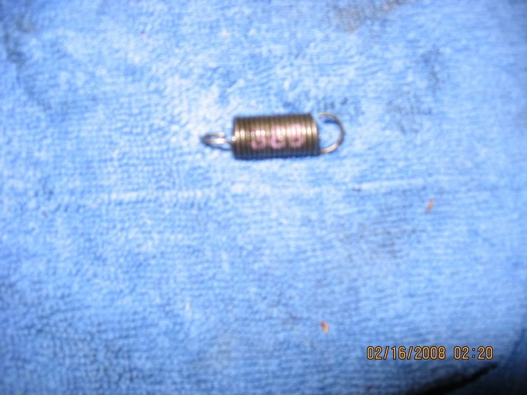

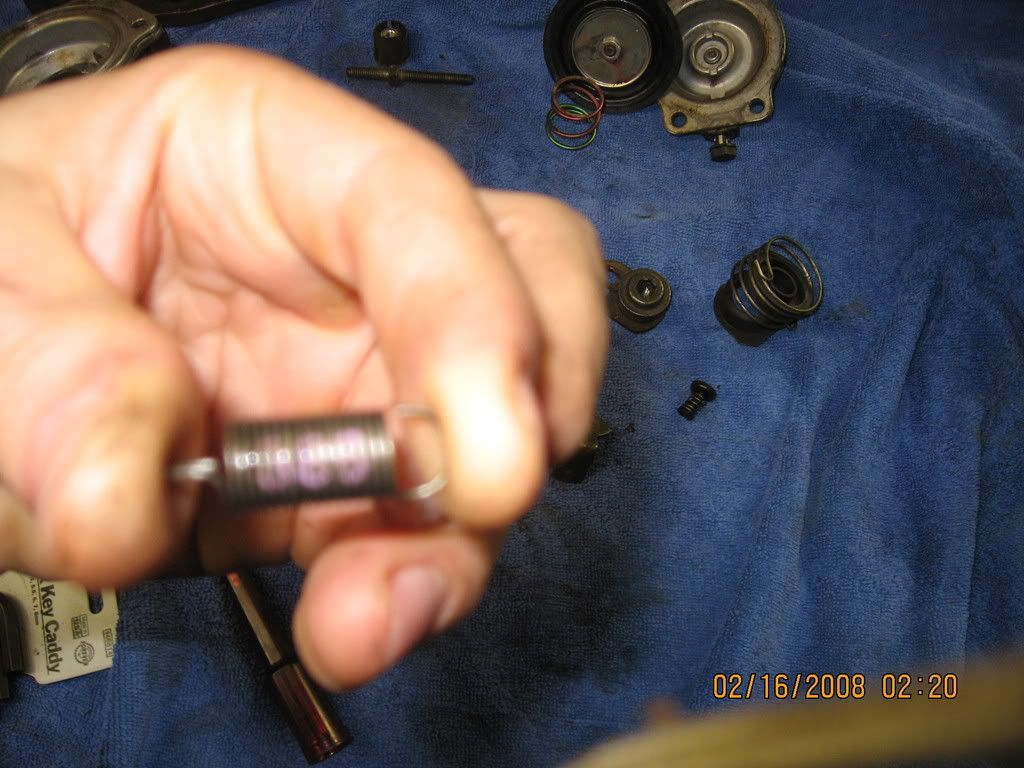

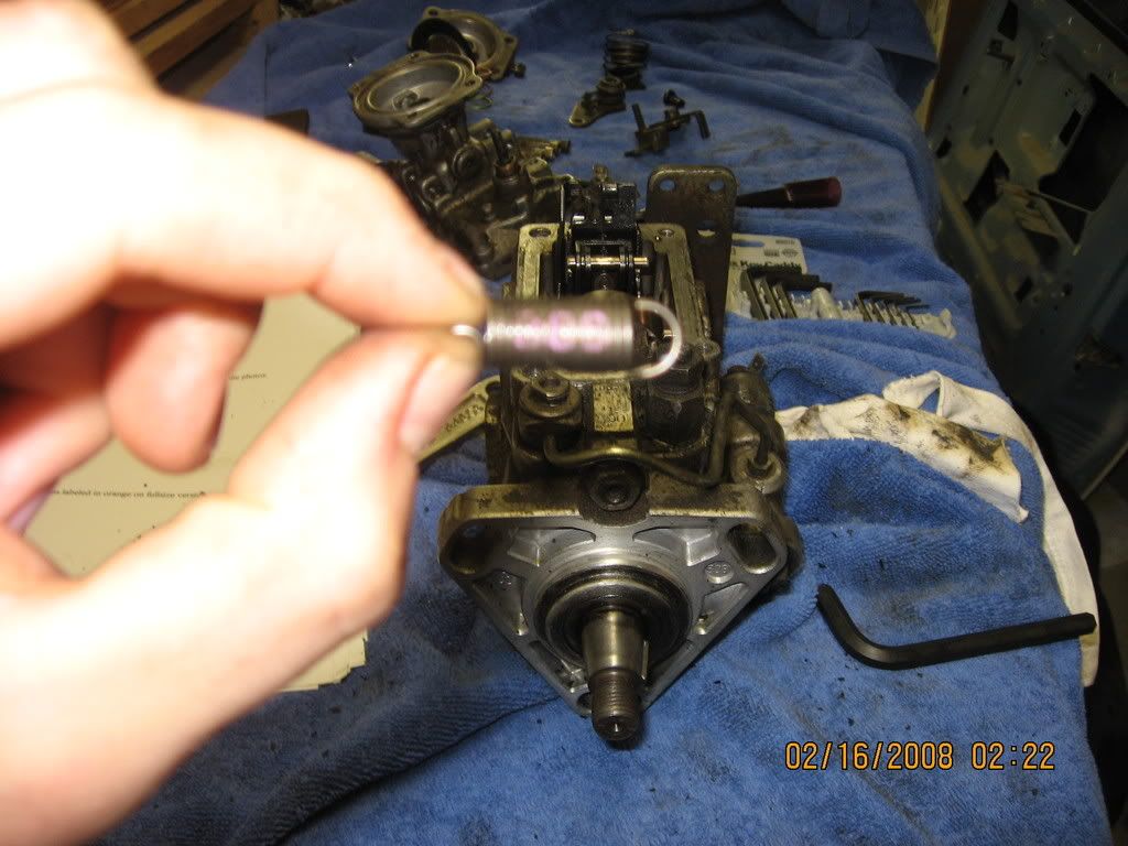

Hey guys, i just pulled apart the pump that was on my old motor and i found what looks like an aftermarket governor spring. I have never seen a stock spring, so i dont know what they look like, but this one has pink writing on it, and it looks like it says 388?
here are some pictures:

3200 would be a "366."

388 is stock.
