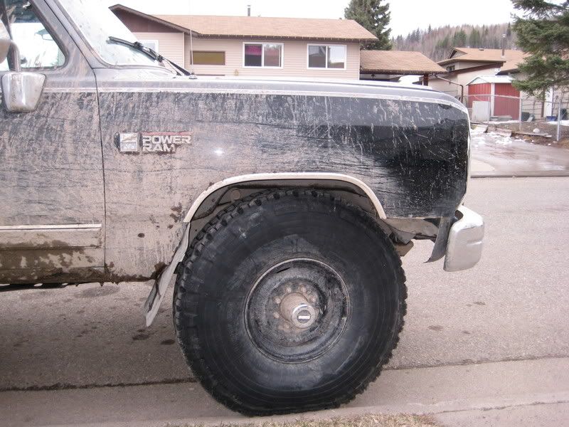

Postby nooblet » Mon Apr 14, 2008 12:58 am
40" militaries and a welded front and rear diff!!
I love it, bravo!
Did you take a chop saw to the fenders?

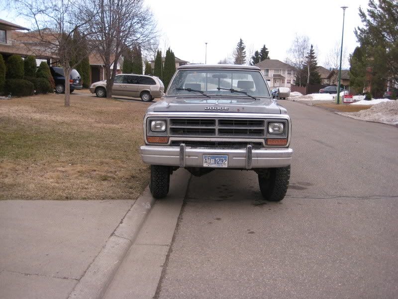

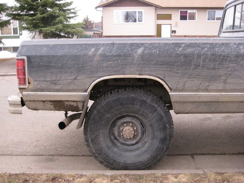

Postby dvst8r » Mon Apr 14, 2008 8:12 am
Just a small trim on the front fenders with an angle grinder. Could have done it a lot cleaner, but really didn't care at that point. Needs a little more wheel offset as well, it rubs near full turn right. Hits the idler arm off the steering box.
I think I will get some extra rear springs and put them up front, should move the axle forward a bit, and give it about 3" - 4" lift, and then do a shackle flip in the rear, and make up a traction bar. I really want to put a set of MOG 404's under it, but we will see how it progress's. I thought I had an action shot of it going uphill pushing through 4ft of snow, but I guess it wasn't on this camera, I will ask my friend I was wheeling with tonight.

Postby PToombs » Mon Apr 14, 2008 5:29 pm
Those tires are really skinny! When I saw the height I thought they would be like 18 inches wide! :lol:
Postby dvst8r » Mon Apr 14, 2008 6:33 pm
PToombs wrote:Those tires are really skinny! When I saw the height I thought they would be like 18 inches wide! :lol:
Logger retread winter tires. Normally guys run these chained up.
As far as mog's I know a guy that is running them under a 77 dodge, with a 440. Basic pinion conversion, some 4" springs all the way around (I thought it was overkill) Converted the brake lines (metric on the mogs), ran the locker lines (iirc bicycle brake cable was used here), and I think the steering setup was close as is. Iirc the mogs are like 3" wider wms to wms. Then I would just run the same style xl 40's except on 20" rims. (probably some double beadlocks)
