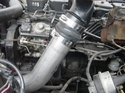

So, does my truck have a ve pump?
1990 w250 4x4 5sp.

Postby boostedve » Wed May 14, 2008 7:46 pm
is it a diesel :P

Postby Philip » Thu May 15, 2008 5:42 am
If you truck has the orginal engine most likely it is a VE. I bought my 366 spring from Schied Diesel.
http://www.scheiddiesel.com/turbos.htm
If your pump looks like the one in the pic minus all the dirt and grim then it is a VE. :lol:
