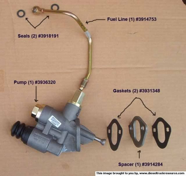

A piston pump is a very good upgrade. If you need installation help, I have a link that is very helpful. This picture shows everything you'll need, and the part numbers.
I'm not sure how accurate the part numbers are now.
Postby Swaggs » Sat Nov 28, 2009 7:14 pm
l really want to do the piston Lp. where can you still get the low pressure pumps?

Postby peobryant » Sat Nov 28, 2009 7:17 pm
As far as I know, Cummins and Case are still the places to go for one. Case used to be cheaper, but when I checked a couple months ago, the Cummins unit was cheaper.
Postby 1STGENFARMBOY » Sat Nov 28, 2009 7:50 pm
I think a 2nd gen pump and regulator would be what you want, first it's about the same money, second a few more mods and you will still be able to pull the low preshure pump down, ask Richie. third i checked three months ago and the Case/IH dealer here was over $350 :shock:
Postby Richie O » Sat Nov 28, 2009 9:33 pm
Some of my issues of drawing down a low pressure piston pump may be my stock supply lines and pick up. I can draw it down to 3 psi. For sure it is way better then the wimpy diaphram. I only saw 3.5 psi with that and drew it down to 0 pretty easy. I am sure my 89 ( stock lp ) is pulling to 0 also ( gauge still on the dresser ).
