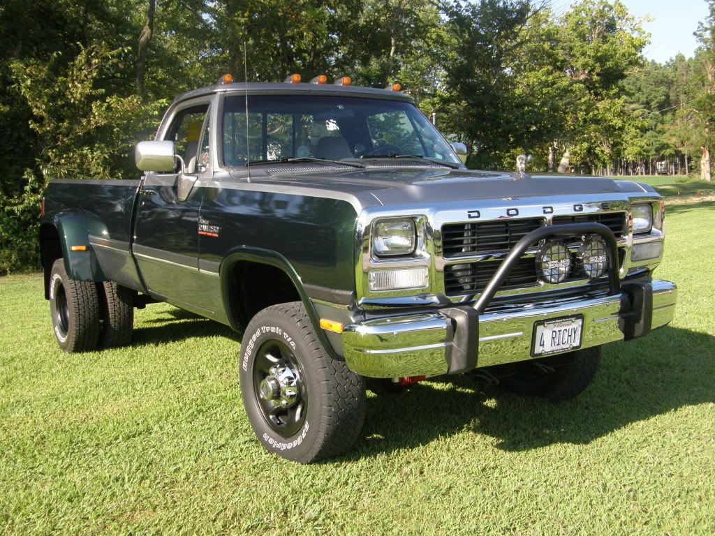

Postby 1STGENFARMBOY » Thu Aug 18, 2011 6:49 am
It is defenatly about what you plan to do, If you have no EGT's problems and don't plan to mod
then i would put in a 1st gen, reason #1 is there is more available from other swaps.
but if your gona crank-r-up then i feel like a P/S is a nice upgrade, but alot of guys like there 2nd
gen one, so i guess if your gone mod i would keep my eye open for a P/S (OR) a 2nd gen and whitch
ever one i found first i think i would get, because evedently they both work well.
here's mine in the grill.
